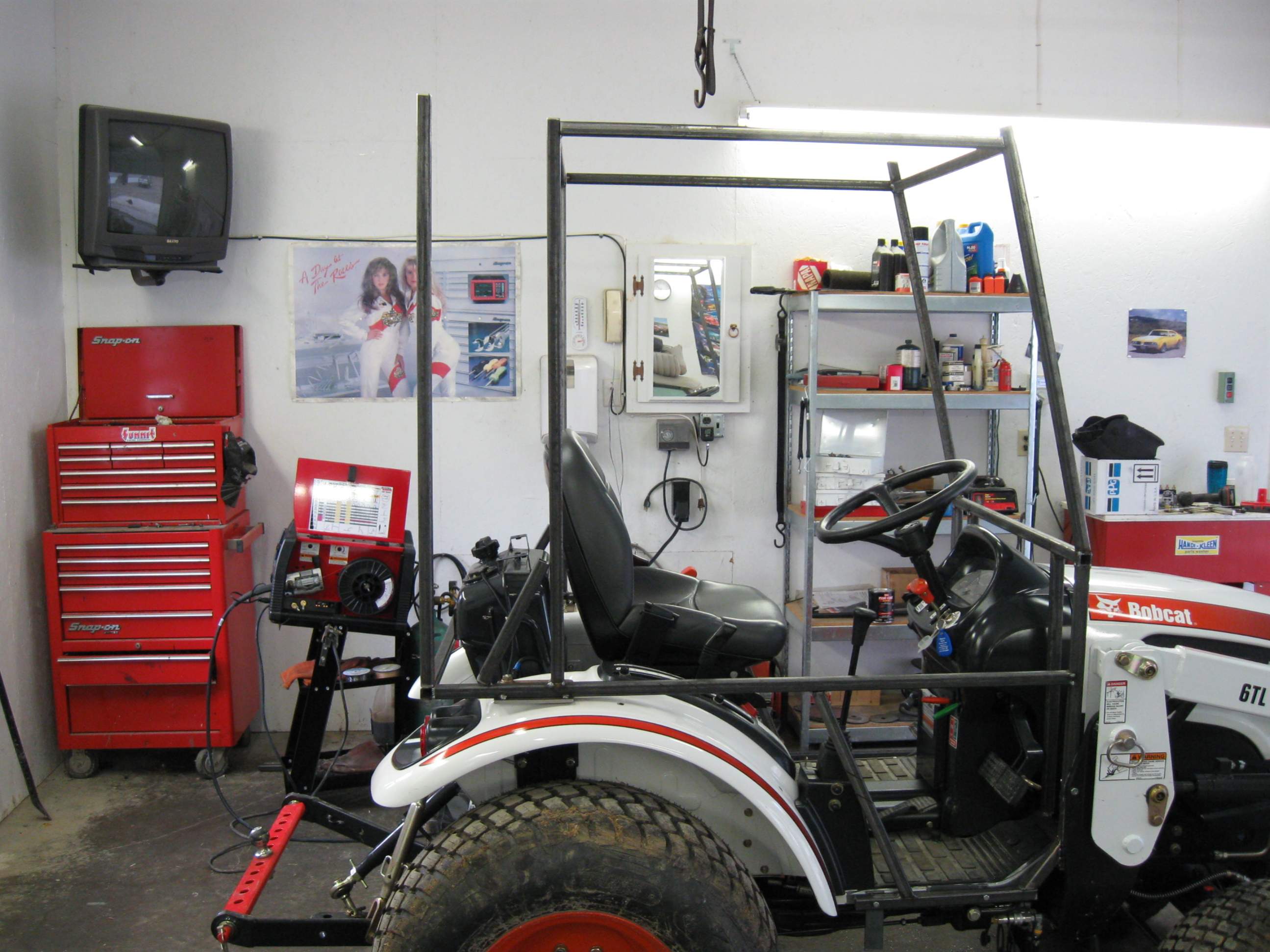

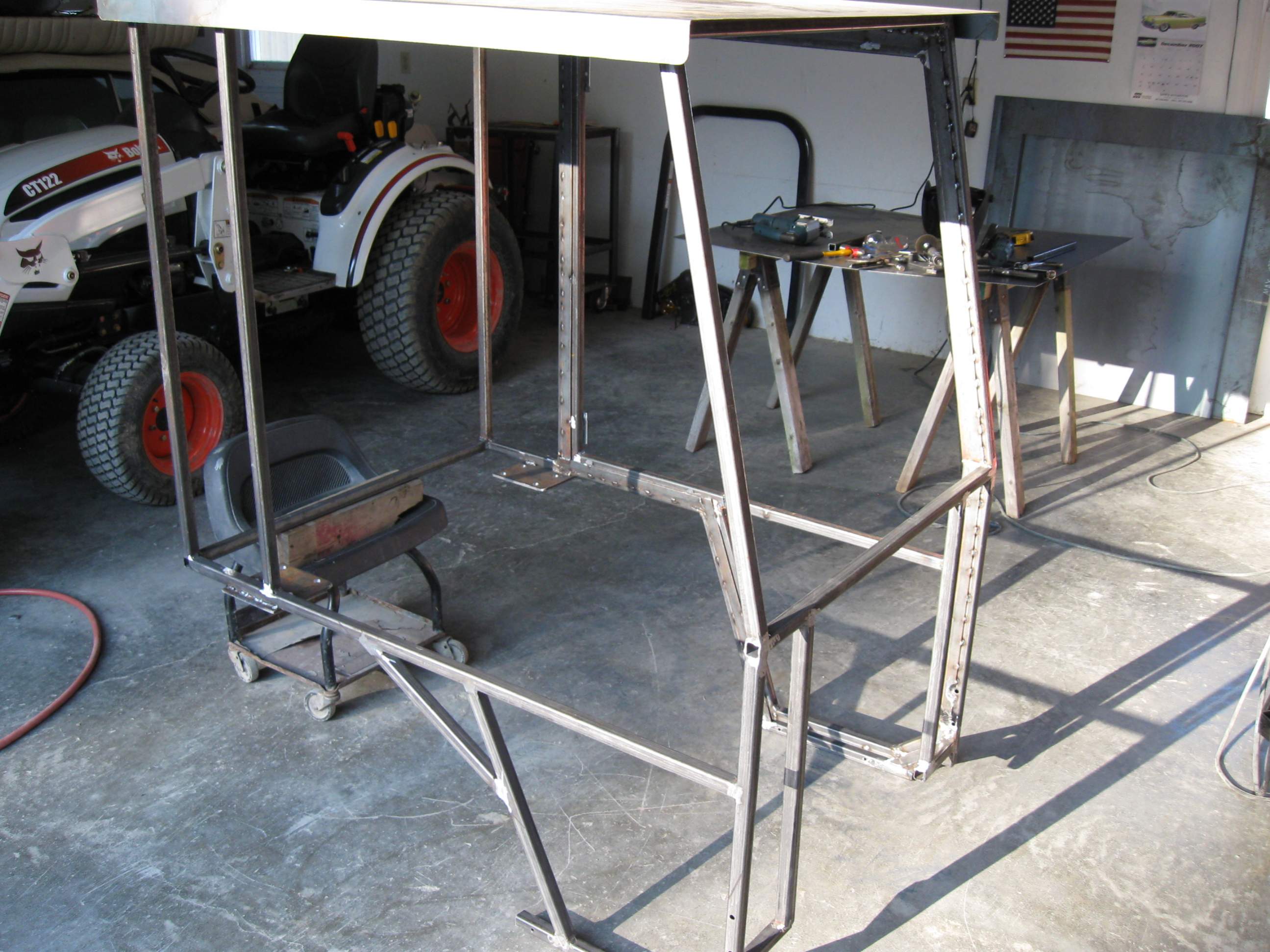

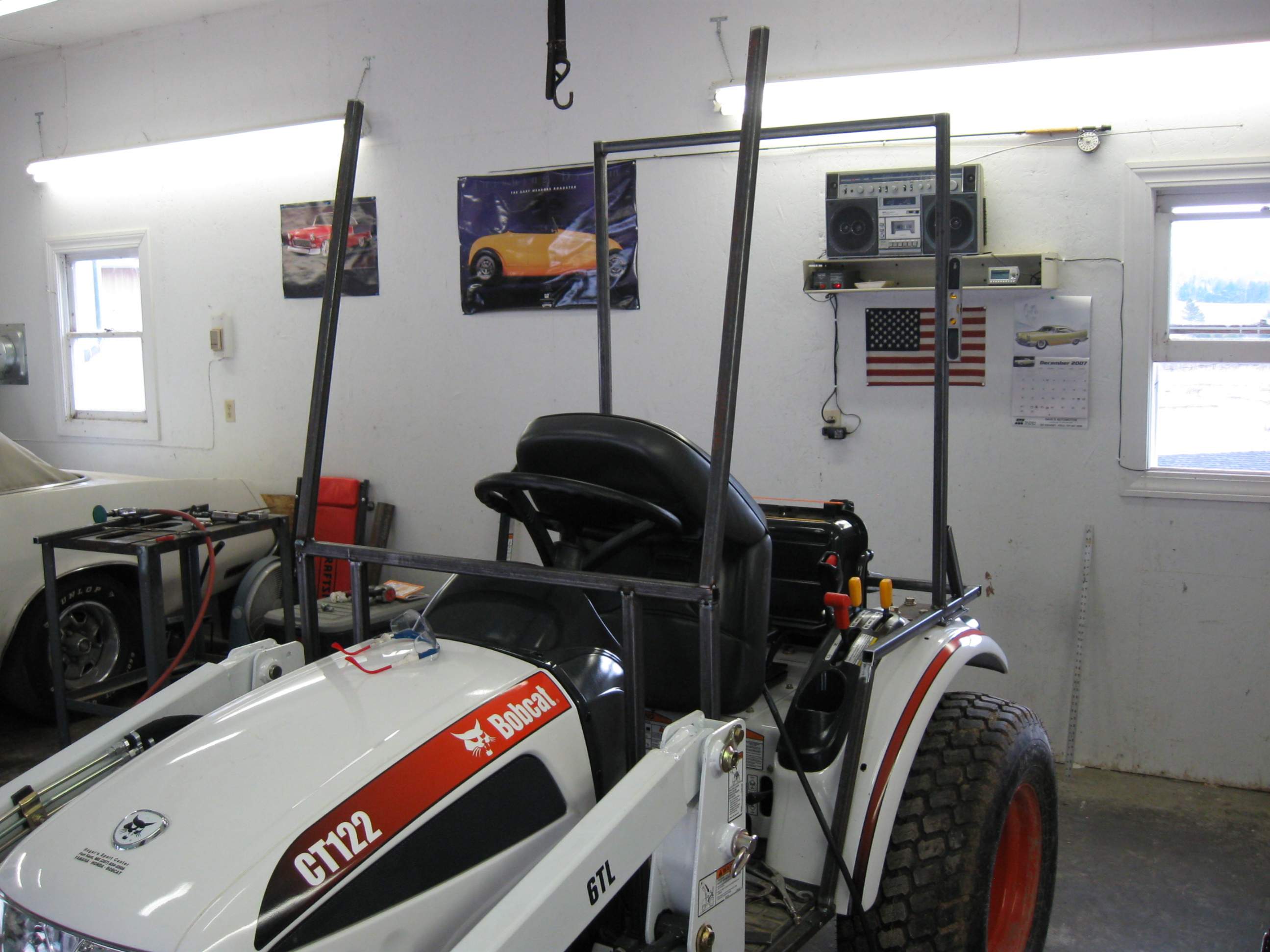

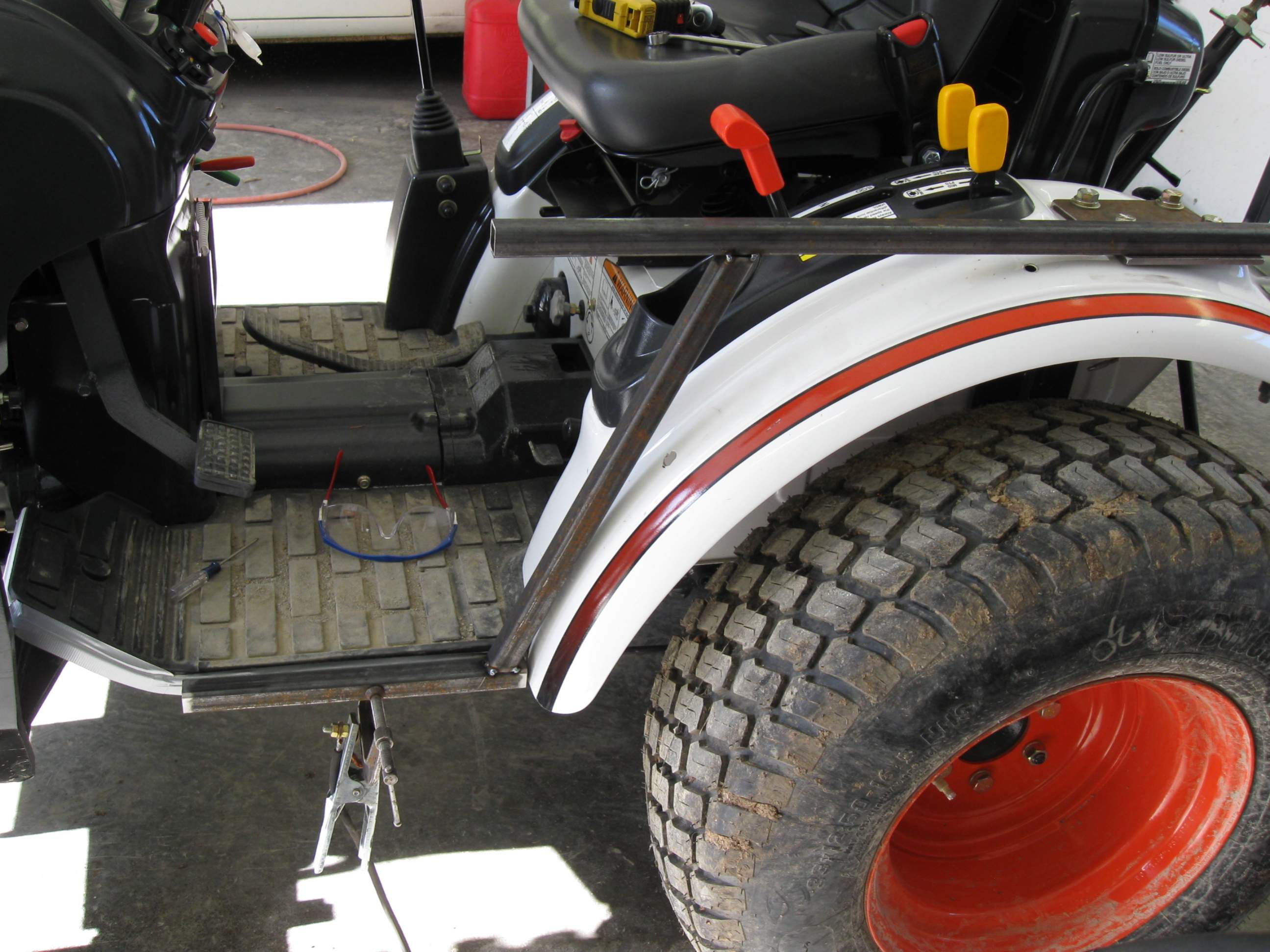

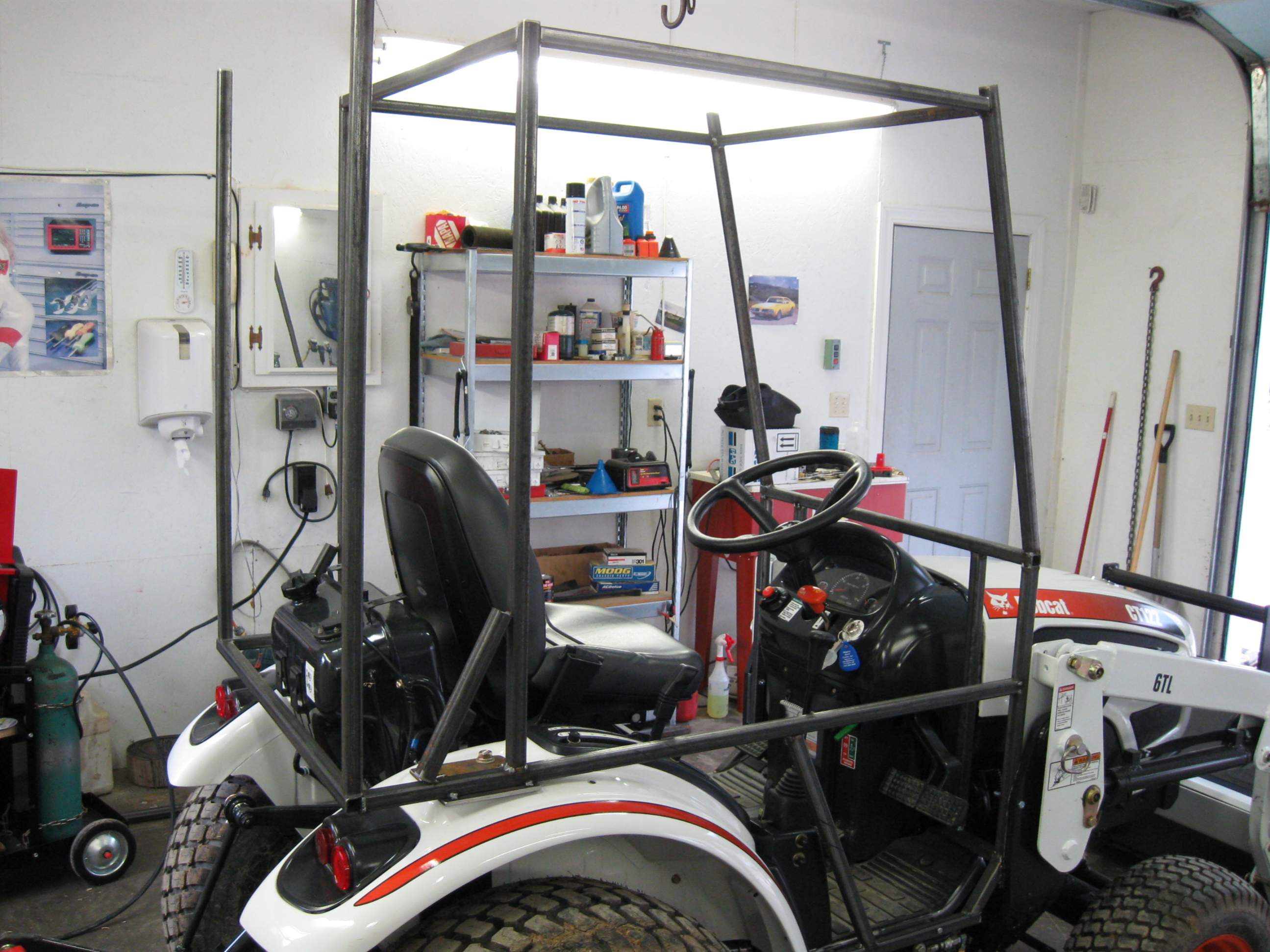

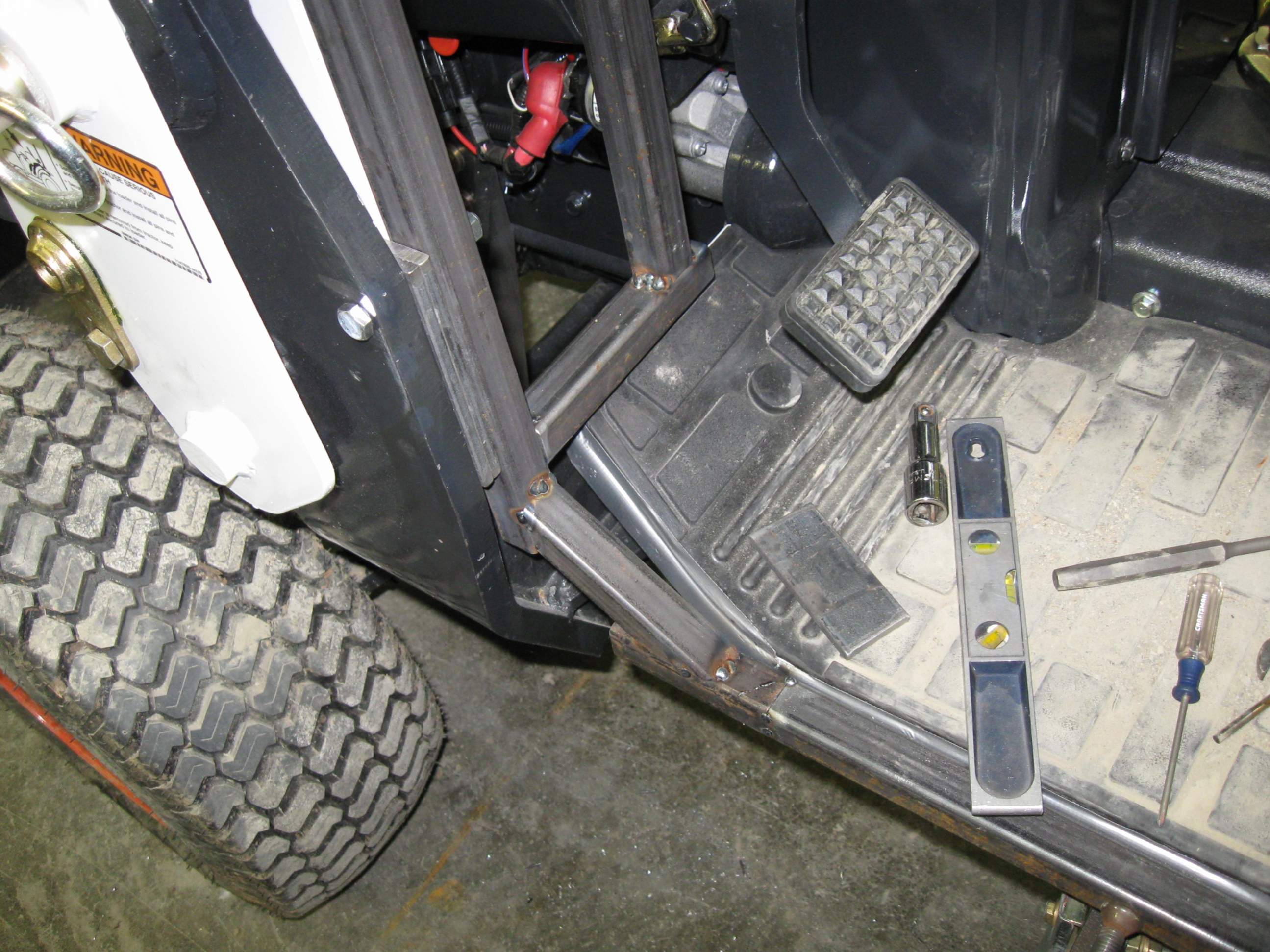

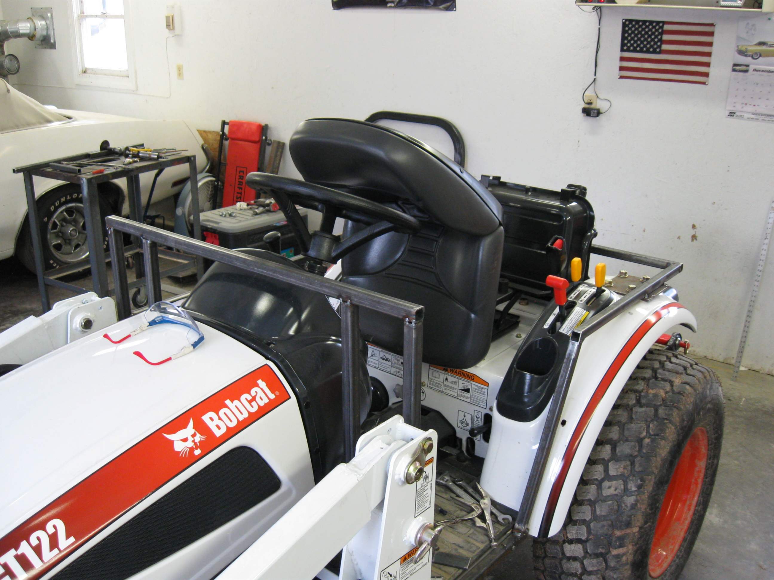

i am about 75 percent done and have a ton of build pics. i will post pics as soon as i can. i used some great ideas from pics a guy on here 'DEON' had posted a while back. the link is a few posts behind this one. best ideas i like are weld a frame out of square tubing, build it twice as strong as needed, and make the mounting points 5 times stronger than you think it needs to be. i mounted it to the fel bracket and to the rops bracket after removing it. 3|8'' steel plates and 14mm bolts. then welded 16g sheet metal all over then cut out the windows. suicide door with cylinder and john deere latch and hande. stainless comercial ball bearing door hinges also. gray tinted safety glass all around. grinding and fiberglassing all welds and painting with ppg base cear paint. bobcat charcoal gray with a white roof.

here ia a few pics of cab build. will post all on build it yourself forum.

tried again here.

more pics.
