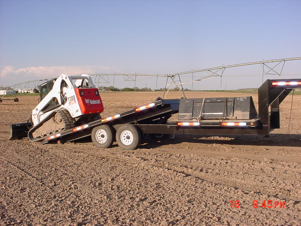

I have had both tilt and deckover. Tilt trailers are great for loading rolling equipment. Super simple and quick to load and unload. Deckovers shine when it comes to wider equipment and cargo. If I only hauled my skid steer and tractor I would still have my tilt. However, I now haul a small dozer and bundles of lumber. The fenders of the tilt would not allow me to load the dozer and made it difficult to forklift load and unload lumber.
Just get a deckover tilt. :thumbsup:
Picture from Google Image Search.
   / Buying a new GN trailer: tilt or deckover? #34
Just get a deckover tilt. :thumbsup: <img src="http://www.tractorbynet.com/forums/attachment.php?attachmentid=357846"/> Picture from Google Image Search.
That's what I have and suggested.
