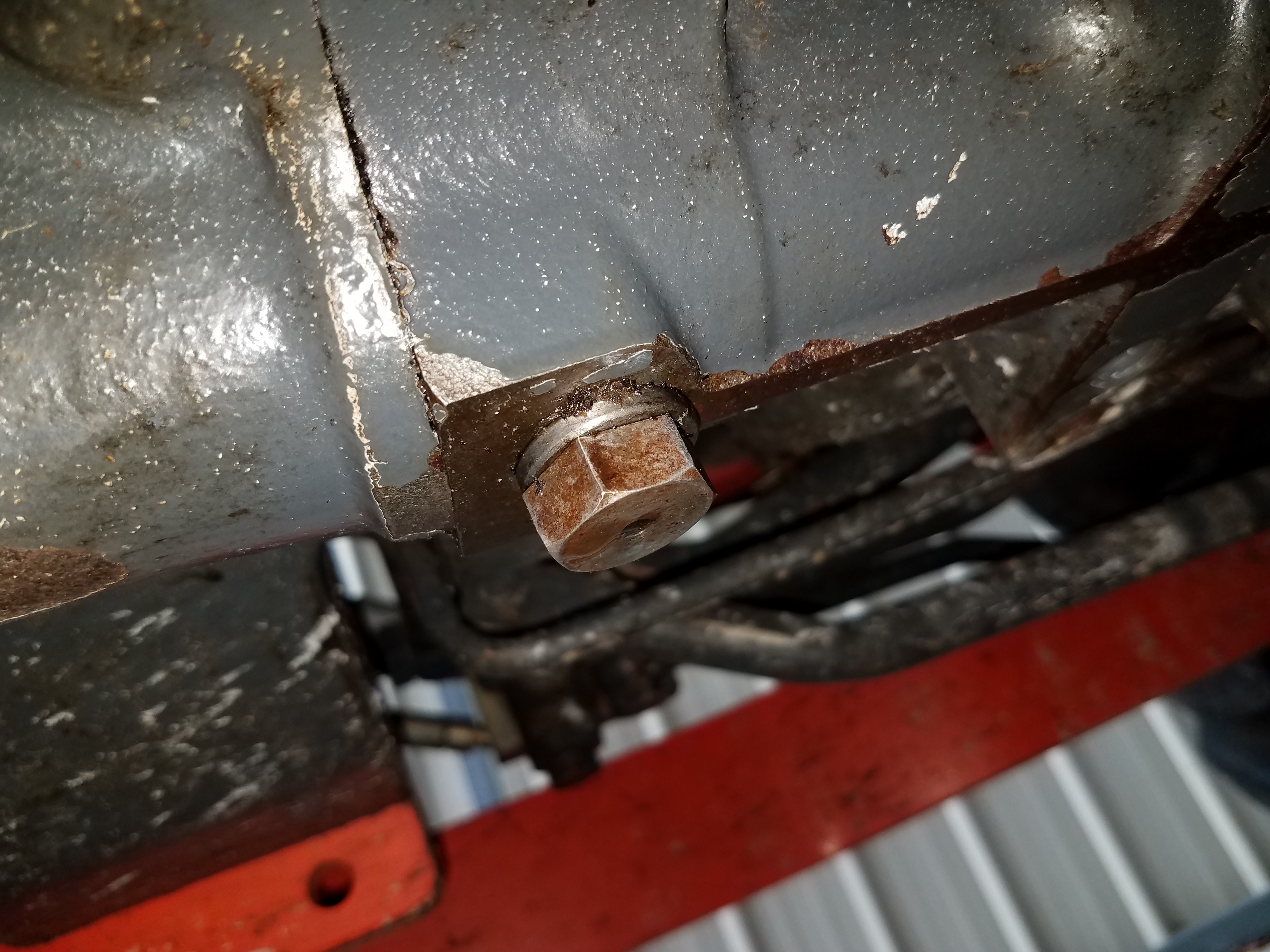

Well I did a more detailed inspection of the tractor today and it has been neglected to some extent. There is a transmission fluid leak coming out of the clutch housing drain plug. The bolt with the hole in the middle that is supposed to have a split pin in it. It is dripping enough that in a few minutes that there is a small puddle of fluid on the ground. I am thinking that this means there is a leak around the transmission input shaft seal that is filling the clutch housing with transmission fluid. I think you have to split the tractor to fix that. There is a smaller leak at the back where it looks like the gasket needs replacing on a square cover just in front of the axle housing. There is drain plug in the middle of that cover. I am not so worried about this one.
Everything worked as far as the transmission and hydraulics. The loader works fine and it would lift the front end off the ground. I am not sure that this tractor is such a good deal if it will require the tractor be split.

Perry - when my L5740 did this it was the seal on the front wheel drive shaft exiting the transmission. I believe it is the same setup hydro or glide-shift. Requires splitting. Some have done this by themselves but I chose to take mine to the dealer where it waited in line for others needing the same seal replacement. My oil was replaced much more frequently than specified so that wasn't reason. Its the nature of the beast - some are going to leak and some last.

How much did the repair cost you to have done? The bottom line is that it needs to be fixed. I would think that having oil in a dry disk clutch would not be good. What else will fail once this is fixed?
The good thing is that the fluid is clear and does not appear to be contaminated. I may end up using the B7800 with the 6ft belly mower to mow for the short run. It is a bit small for 44 acres but it will sure mow some grass. It has a 35HP 4 cylinder engine compared to the more noisy 3 cylinder 34HP in the L3430.

Well I decided to not buy the tractor. It was probably a good deal but I did not want someone else's problems. If the seal was the only thing wrong with it and it had been properly maintained that would be different. I guess I am not redneck farmer who keeps stuff running with bailing wire and duct tape. I also did not like the computerized GST transmission that was 15 yrs old and has had no maintenance. Electronic stuff does not last forever and when it goes it is not cheap. The guy had enough money that taking a $21,000 tractor and running it into the ground did not bother him. He is through with it, so it was a good deal for him. 15yrs of abuse and no maintenance. I look forward to the time when I have enough time to put into projects like this.
