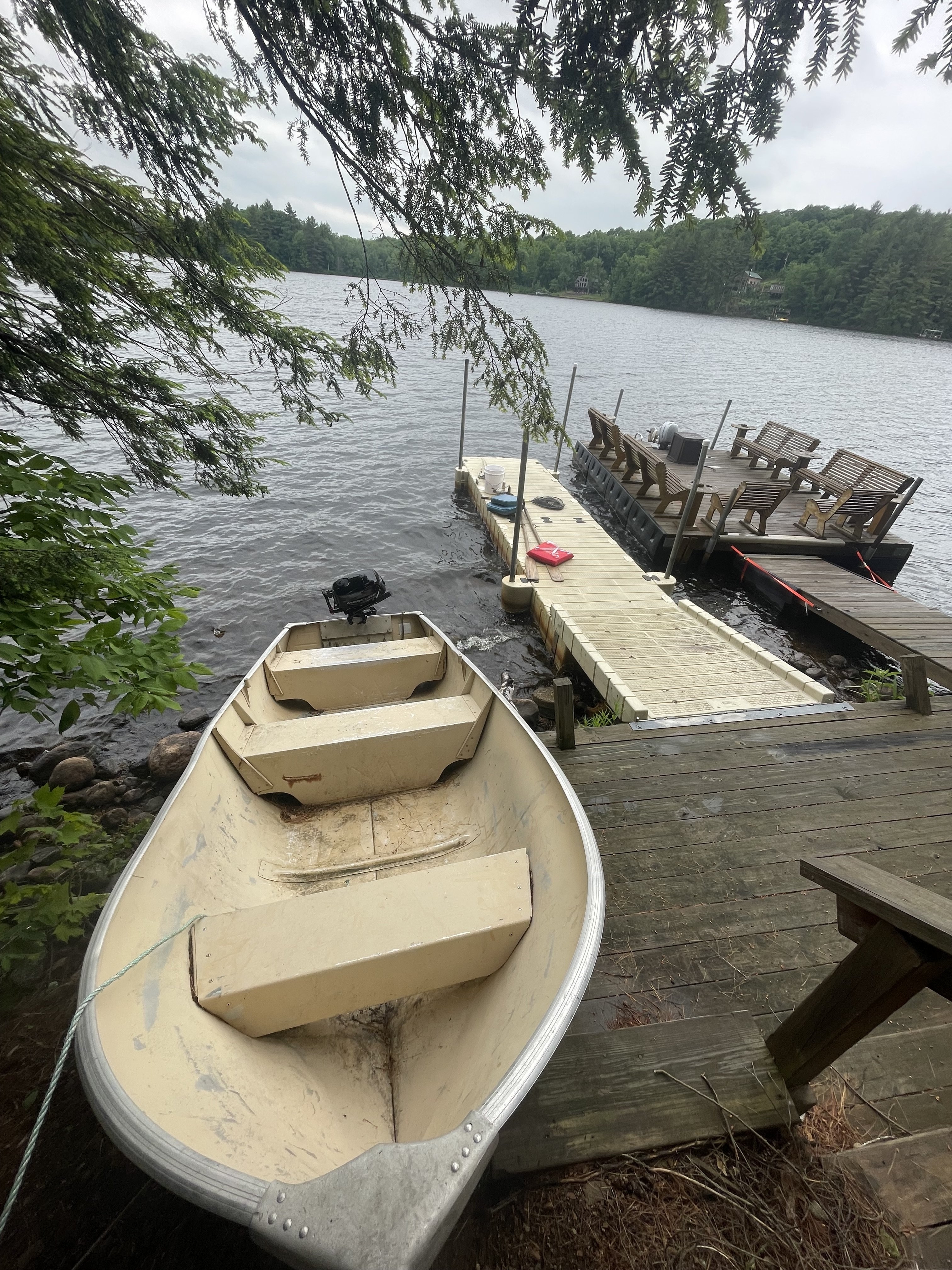

Speaking of outboards, I’m looking forward to some boat racing over this beautiful long holiday weekend. I just got my old, early 50’s Mercury K-5 tuned up. I can’t wait to see if that’s faster than my father in laws brand new Mercury/Tohatsu 5 hp 4-stroke.
There’s a 10 hp limit on the lake up there, so hopefully we don’t piss off the neighbors too bad, racing a few laps around the lake with the 5 hp outboards on 12 and 14 ft rowboats.
I knocked off our lawn with my lawn tractor yesterday and my parents with the new Husqvarna z-454 on Sunday, so no worries about that for a while. I’m ready for some fireworks and water sports now.
