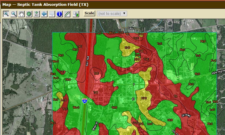

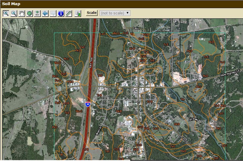

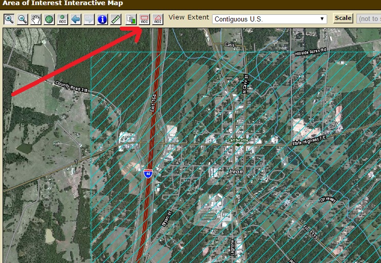

Hey Jack, I am presently located in the Bay City area, and you must be right, because there is no shortage of rural homes here. But my prospective property is closer to Centerville. I will have to see who I can talk to about the perk-iness of the land up there. Although, there are at least 3 homes withing 1/4 mile of this property. So, something must work.
Here's what you can do:
Go to Web Soil Survey - Home click on the big green WSS button
In the AOI tab (up top are the tab labels) zoom in or select Texas, Leon county
Zoom in to your prospective land
In the AOI tab and sub window "Area of Interest Interactive Map" you'll see the a red rectangular button labelled aoi. Draw an aoi around the land, it can't be too big, like 100,000 acres.
example
Go to the soil map tab
example
There is a full set of what your soils are in http://www.nrcs.usda.gov/Internet/FSE_MANUSCRIPTS/texas/TX289/0/leon.pdf, which is good reading.
Or you can go to the "Soil Data Explorer " tab and the sub tab "Suitabilities..." slide down the right side and select "Sanitary Facilities", thence "Septic Tank Absorption ..."
and get something like:
And you've got a good first look.
