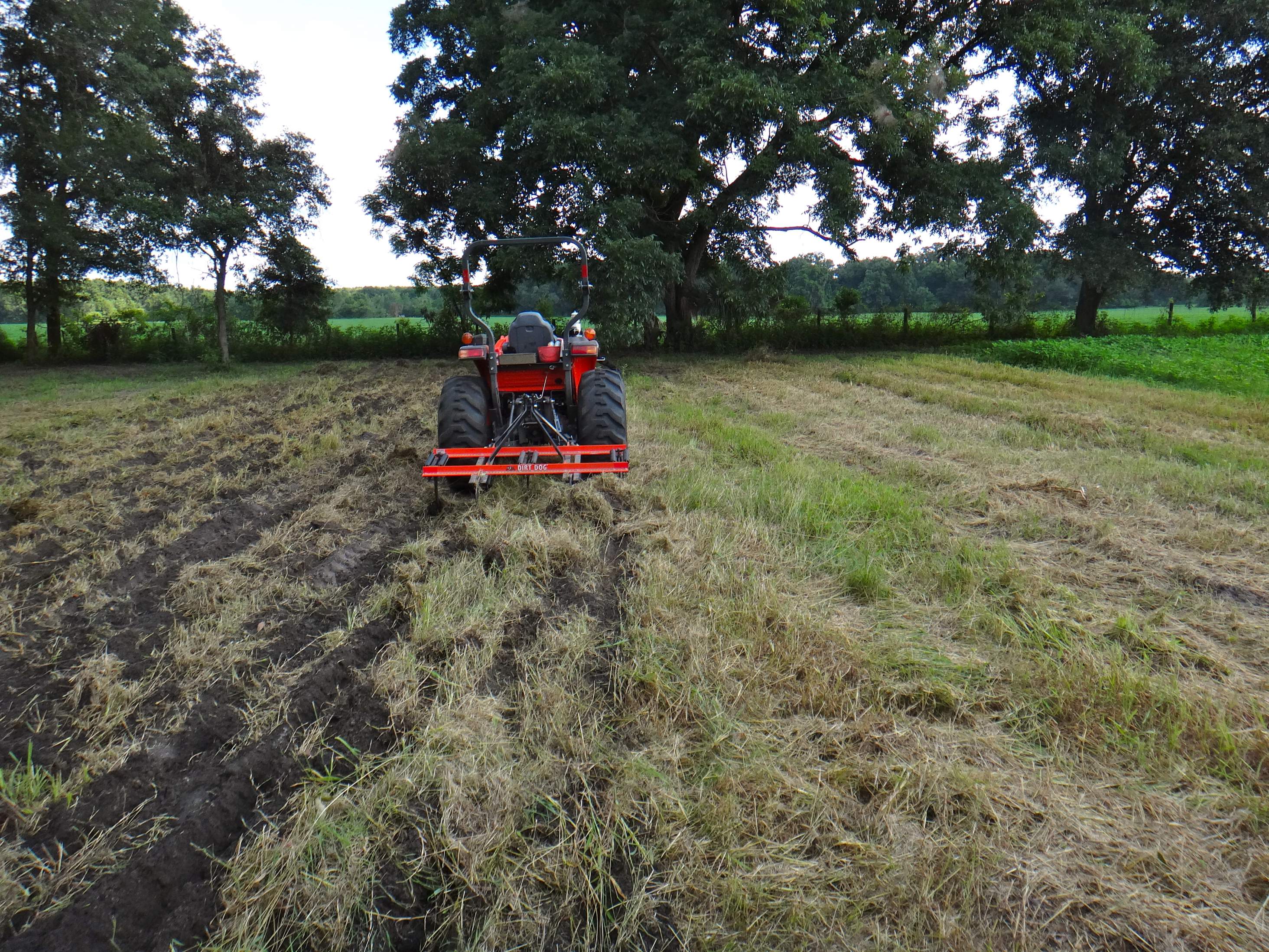

A Rotary Cutter (Bush Hog) is a much more rugged mowing implement than a Flail Mower.

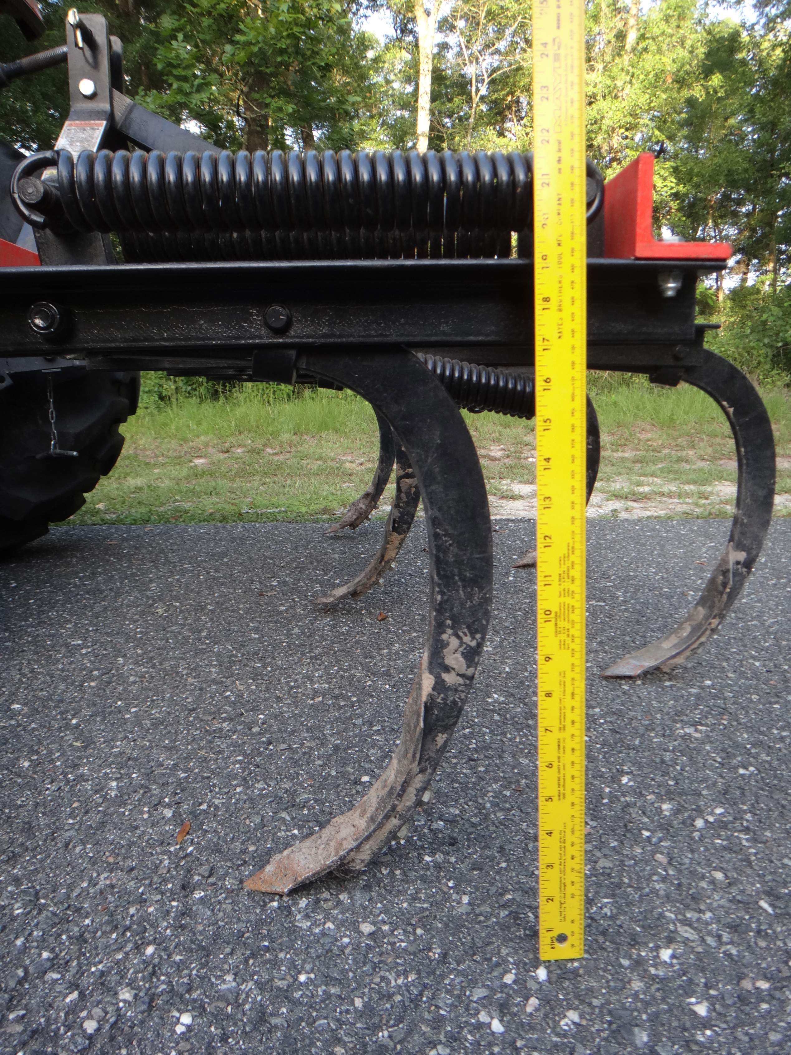

Ponder if a coil-spring protected Field Cultivator/All Purpose Plow would rip out problem Gorse. Ford/Dearborn and Ferguson, among others, made them under different names. PHOTOS #1 - #4
T-B-N ARCHIVE: https://www.tractorbynet.com/forums/attachments/339095-dirt-dog-all-purpose-plow.html?highlight=
- Something to look into, to be honest never something I have seen before
