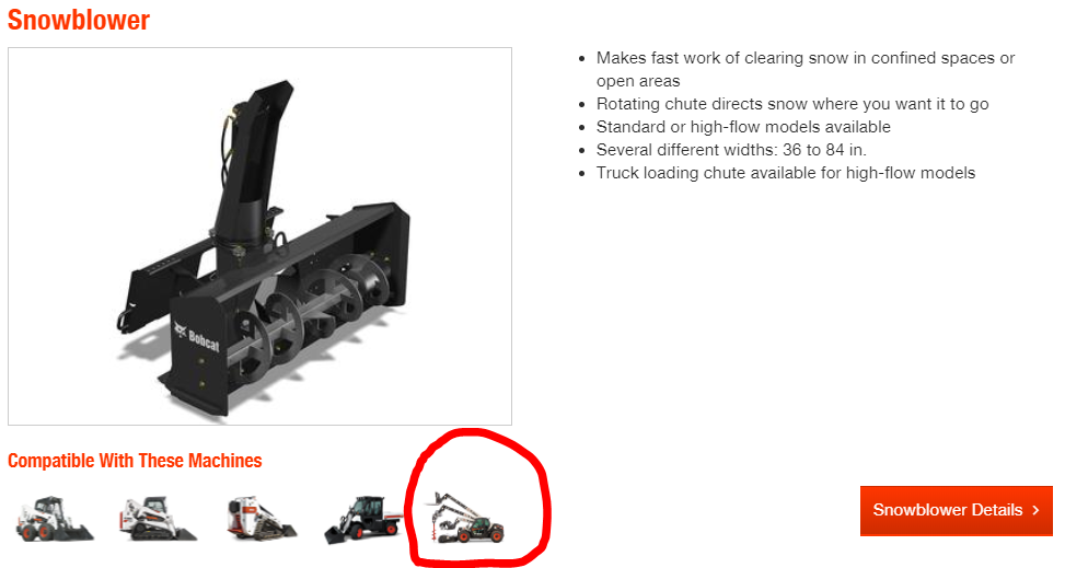

Don't know what you are basing that statement on. Most of the compact telehandlers now have SSQA with aux hydraulics on the boom.
Bobcat makes a snowblower that will fit my V417 with 22GPM flow. I don't have one because we don't get much snow here. :thumbsup: :D

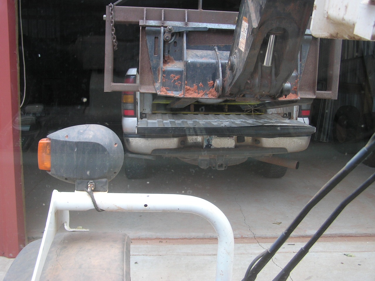

Some compact telehandlers are narrower that the tracked skid steers. I need to take a picture of mine next to the pickup truck to show how small it is.
Here it is with the 6' wide bucket and a 5'x6' hay bale:

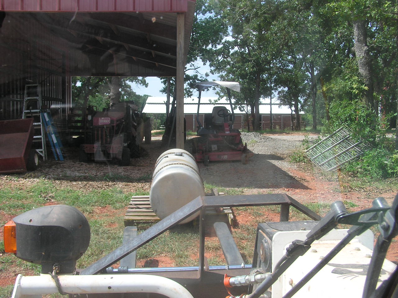

And the fork tips are visible from the seat:

The cool thing about the one above is you can extend the boom and feather and watch it from a good vantage point. I have a tractor and skid steer and don’t like either for loading a pickup bed. My deckover is money with either, pick up box no thanks.

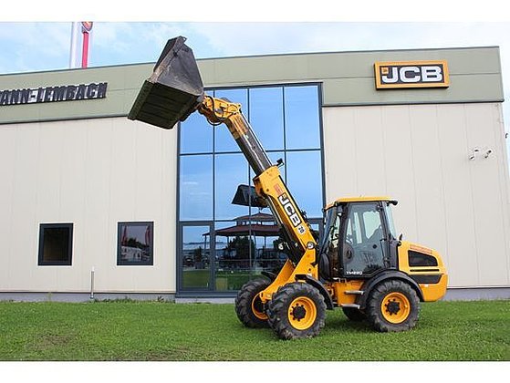

The OP is a maple syrup producer. When I hear maple syrup producer, sugar shack, skids of syrup, I picture a sugar bush full of maple trees... and mud. Go ahead and run a skid steer through a muddy sugar bush and see how that goes. Loading a pallet or two onto a pickup truck once a week, it would be hard for me to justify the cost of a skid steer, especially since the OP stated he does not currently own a tractor. From everything I've seen in maple syrup production around here, a tractor would be much more useful than a skid steer in a maple syrup production environment, especially as a first machine. An articulated wheel loader would also be more useful, and less prone to getting stuck in mud than a skid steer.

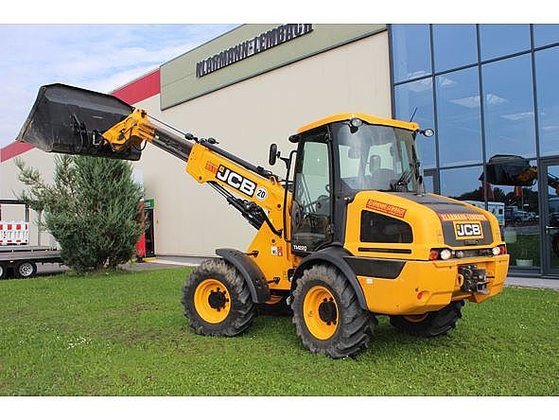

An articulated telescopic wheel loader would be even better: JCB TM22 AGRI Agricultural Telescopic Handler
To each his own, however, I'd never let a skid steer into my woods (maybe a tracked one), and I certainly would never purchase one as my first machine for a maple syrup operation. I'm currently managing a small 1.5 acre grove of maple trees for syrup production when I retire in about 8-9 more years. I've done some research. I've helped out in a sugar bush for a friend of my wife's that has 65 acres of maple trees in syrup production. So I have some minor knowledge of how its done. It's not the right first machine overall for the tasks associated with the big picture of the total operation. I'm looking at the big picture, not just the task of lifting one or two skids a week over maybe a couple month period. Even if he makes syrup for 8 weeks, 2 skids per week at 5 minutes per skid is only 80 minutes of operation per year.... VS how many hours could be put on a tractor pulling a wagon with equipment for setting up the taps and tubing, hauling boiler wood out of the woods, maintaining the woods and grounds, mowing in summer, etc.... all that stuff that tractors excell at VS a skid steer. That's all I'm trying to get at... the bigger picture, not just the lifting of heavy skids. What's the best piece of equipment for the OP for his overall operation? ;)

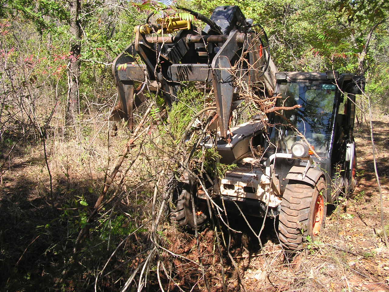

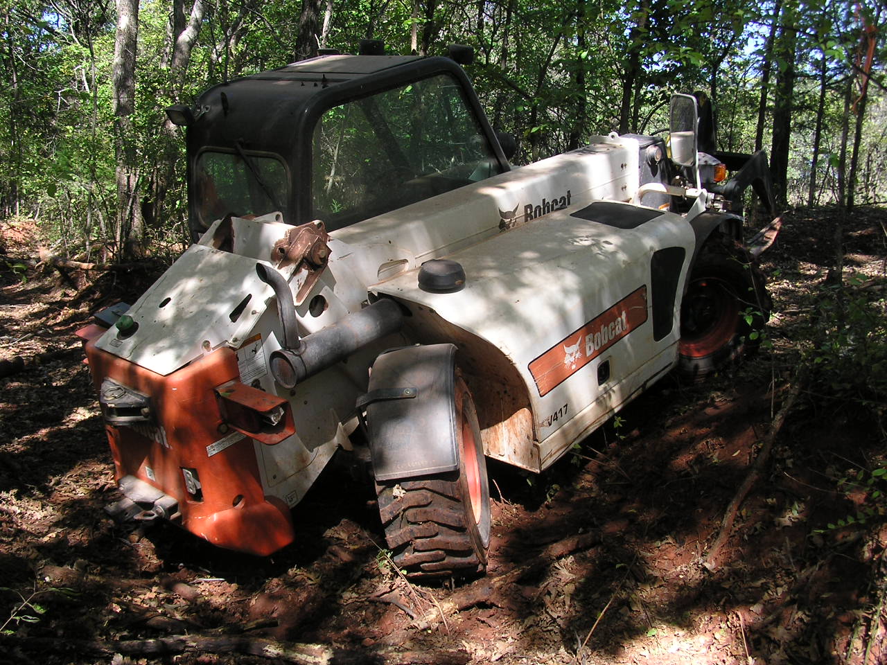

I can do all of that with my compact telehandler. At 6' wide, 6.5' high and 13' long, with 4 wheel steer it gets around great in the woods.
