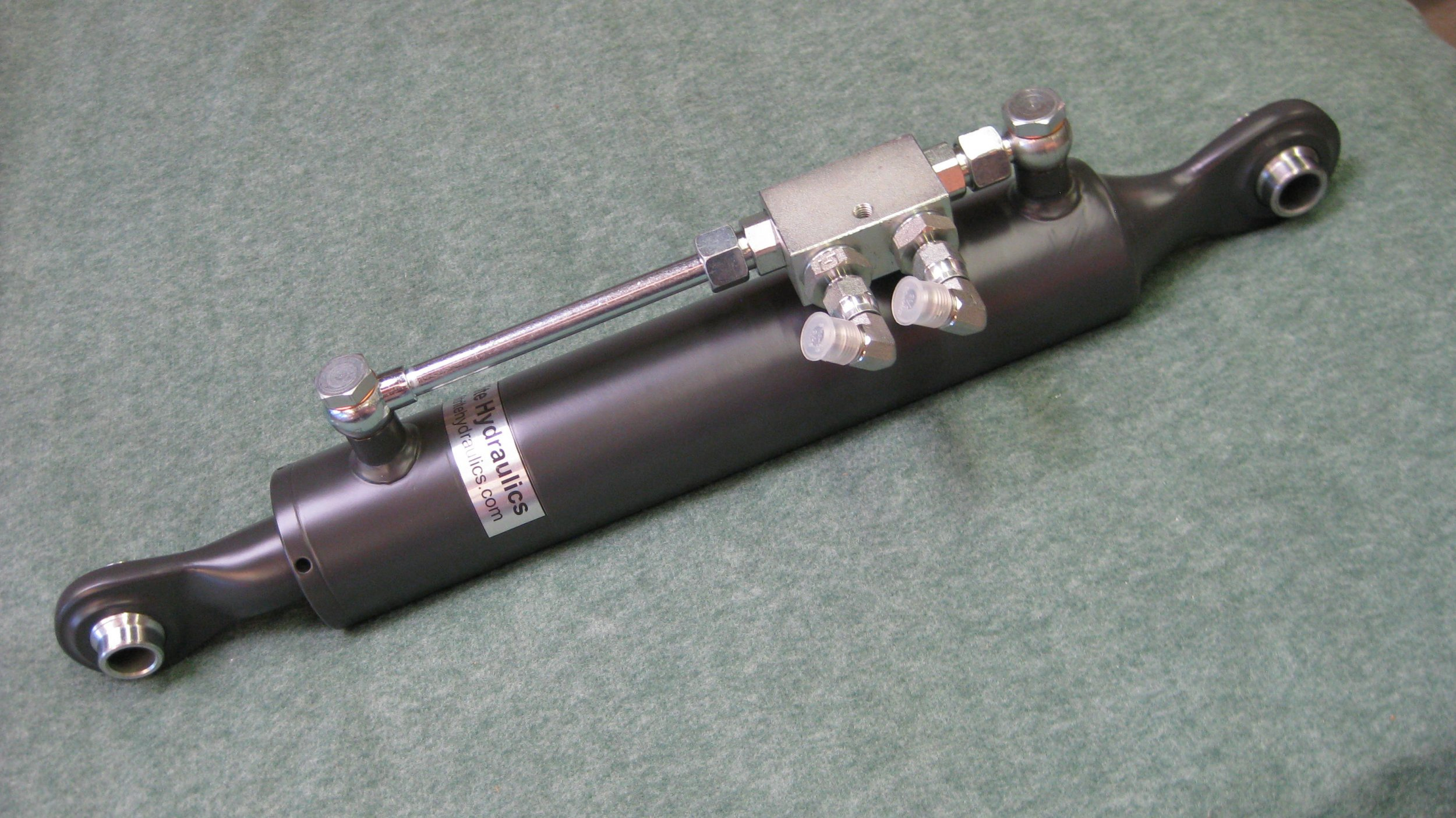

Are you talking about a DPOCV? (check valve)
   / Buying Advice on Hydraulic links #45
Unless you’re ok cutting, flaring and potentially bending some stainless hard line you’d have to remote mount it with a 2nd set of hoses.
I once bought one on amazon or ebay for $50 new because the seller didnt really know what it was..
I admit i also do not know how to easily source banjo fittings… never once bought one, as many times as ive disconnected and reconnected them. 😂 Banjos arent the only way to do it, just the ‘nicest’.

Richard, do you know what port size you have on the top link?
Let me know and I should be able to figure something out.
   / Buying Advice on Hydraulic links #49
I'll figure it out tomorrow. Thanks Brian.
