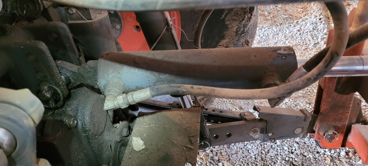

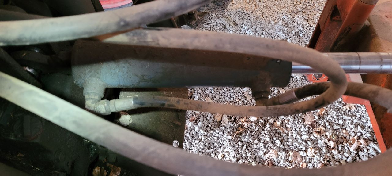

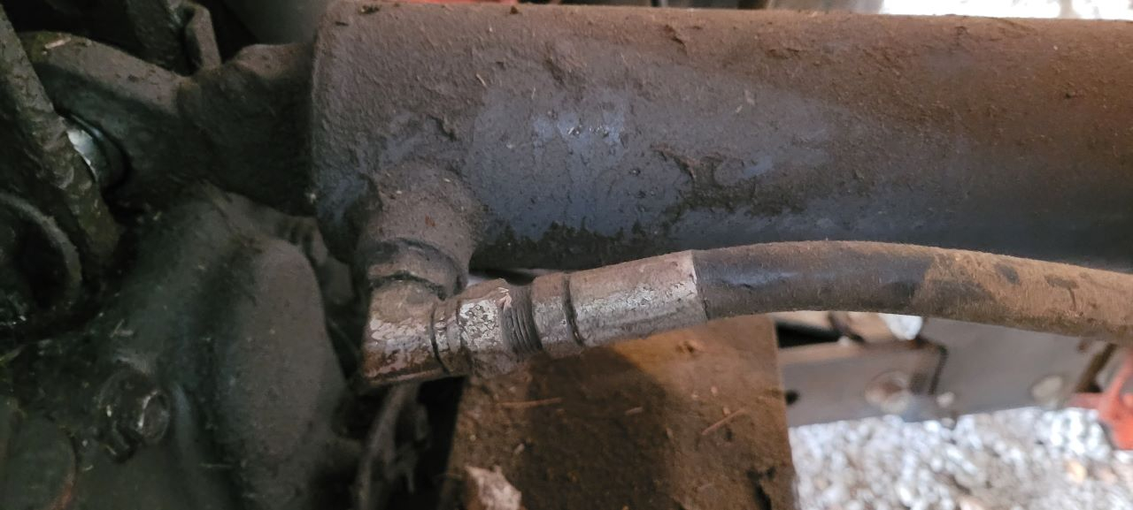

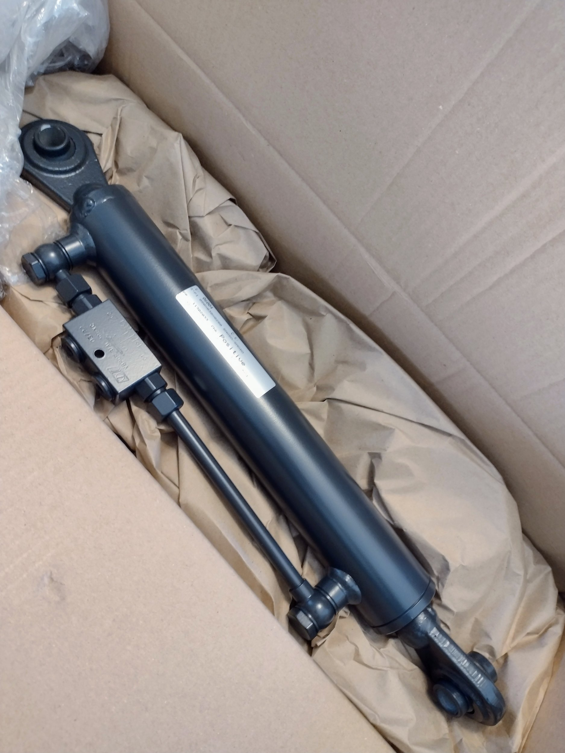

Richard, do you know what port size you have on the top link?
Let me know and I should be able to figure something out.
Brian, here's some pics I took. Of course I'm hydraulic fitting ignorant. I don't recall the size or type of cylinder ports. If you can't figure it out by the pics I'll do some more research. I probably have the receipt for the cylinders. I bought them from Supply House and then modified them to fit my application. Thanks in advance for your efforts. I really appreciate it.

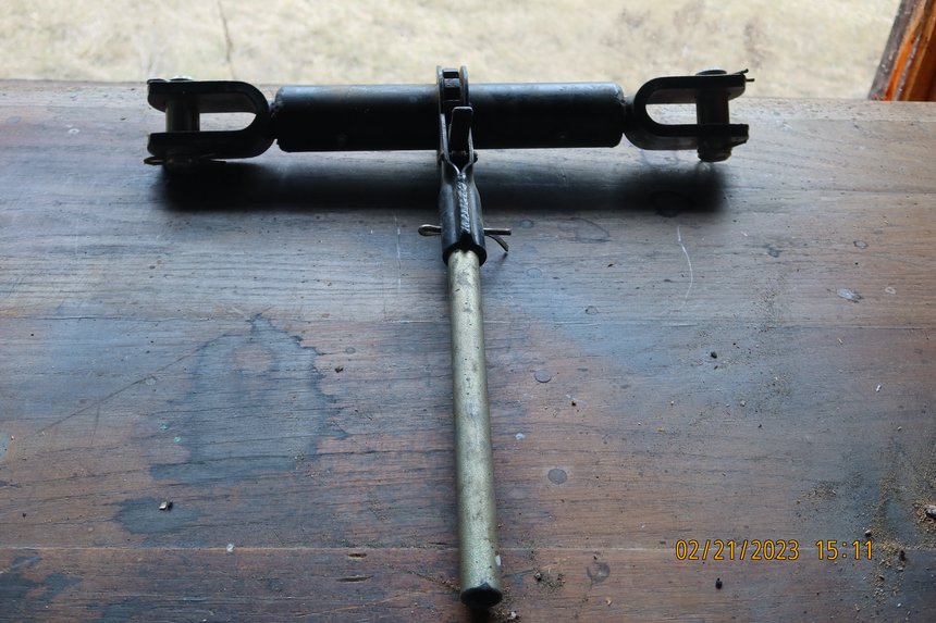

Beenvenue - a shame we are so far apart. I was given a hand crank unit. Never used it. I would give it to you. I think this may be what you are looking for.
I installed that kind of link to offset my rear blade, replacing the telescoping link on the blade. I like it. It’s simple, works fine, and only cost $100. Typically when I offset the blade, I use it like that until the job is complete, then it’s no problem adjusting the blade back to the standard position. Sometimes going full hydraulic isn’t worth it unless you’re going to be constantly changing the setting.
Double check the wrench size, should be 7/8"
Check your PM please.
   / Buying Advice on Hydraulic links #58
Replied to your PM and completed contact page info on your website.
7/8" is correct.
11 1/4" center of port to center of port.
Thanks Brian!!!

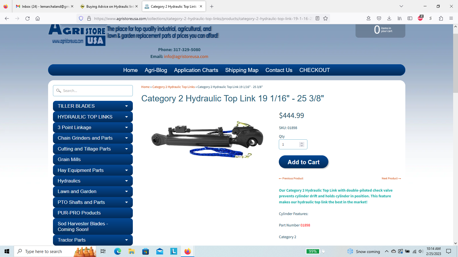

I suppose these are technically parts, but they attach to the tractor, so apologies if this is poorly placed.
I am about to pull the trigger on a T494H (maybe a 4820H or T574H). I want to get a hydraulic top and side link. My primary use will be box blade work on driveway (200-300 ft) and paths. I have some questions for those who have been down this road before me.
1) Have dealer install it or aftermarket?
2) Options/features to look for?
3) Min-Max lengths?
4) Manufacturers with good reputation?
Installation seems pretty straightforward, but somethings are better in experts' hands.
One day (free) ship from AgriSupply. Very well packaged, and I’ll get it installed ASAP.
