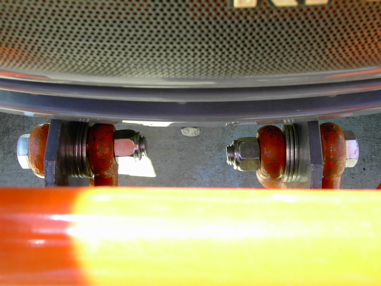

Aug 2, 2006 / buying ck25 or ck30 #21 DirtHauler Gold Member Joined Nov 22, 2004 Messages 465 Location Northern Cali ~~~ "Weed" Country Tractor " '06" Kioti CK30 2015 Mahindra 2555 shuttle 2019 Massey 1760M Oh, I have these mounted (see pic). The holes on the frame are 18mm, you'll have to open them out to 19mm (3/4") to accept a 3/4" bolt. Attachments PICT0298.JPG 59.6 KB · Views: 198
Aug 3, 2006 / buying ck25 or ck30 #22 Highbeam Super Member Joined Feb 9, 2005 Messages 5,321 Location South Puget Sound, WA Tractor Kioti CK30HST Thanks DH, that's what I was asking about.
