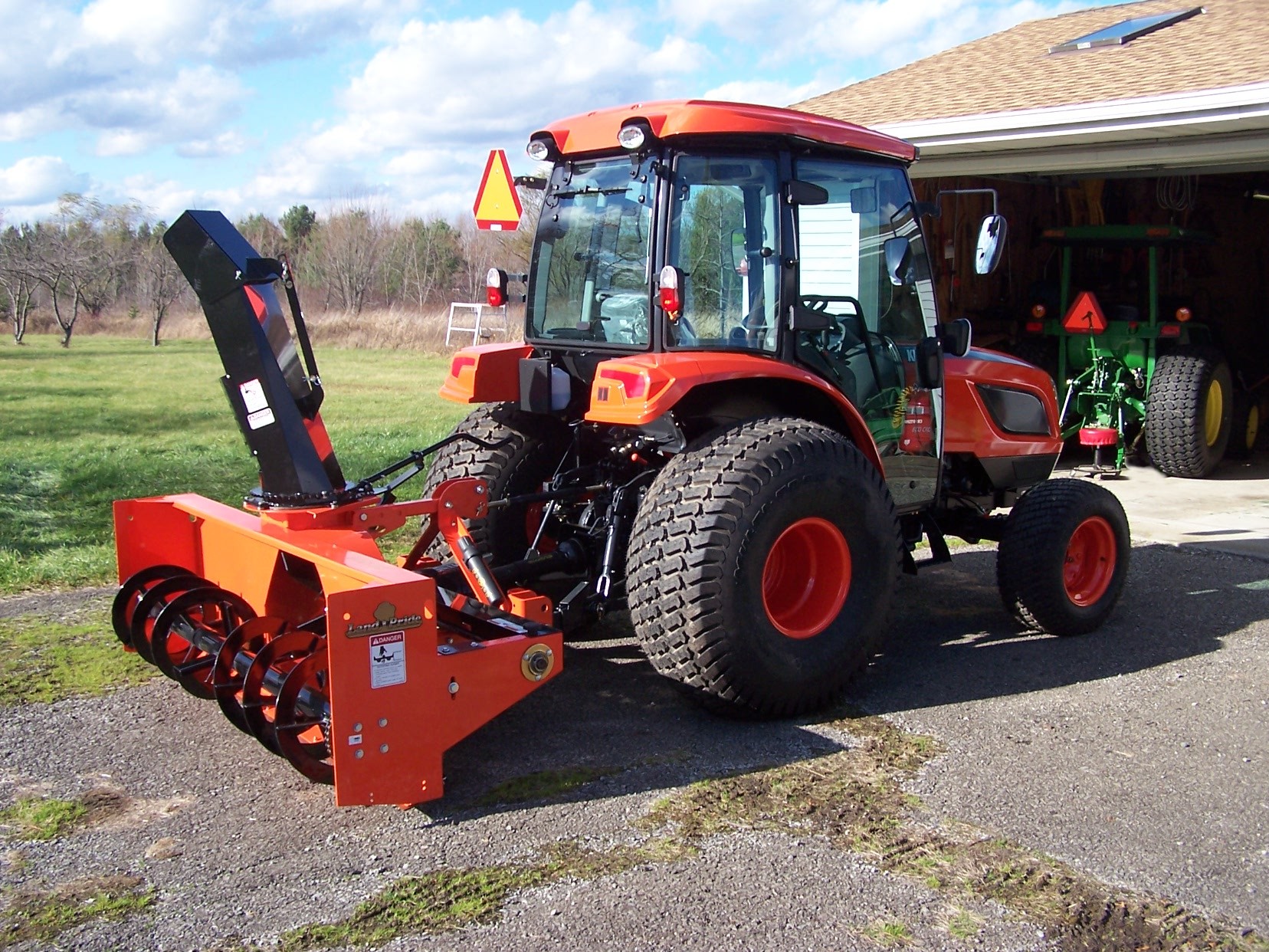

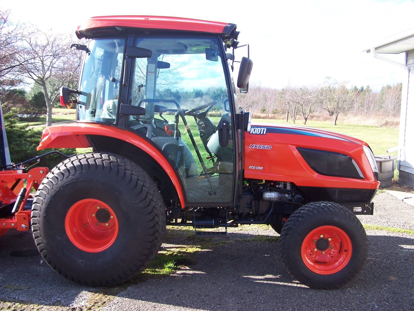

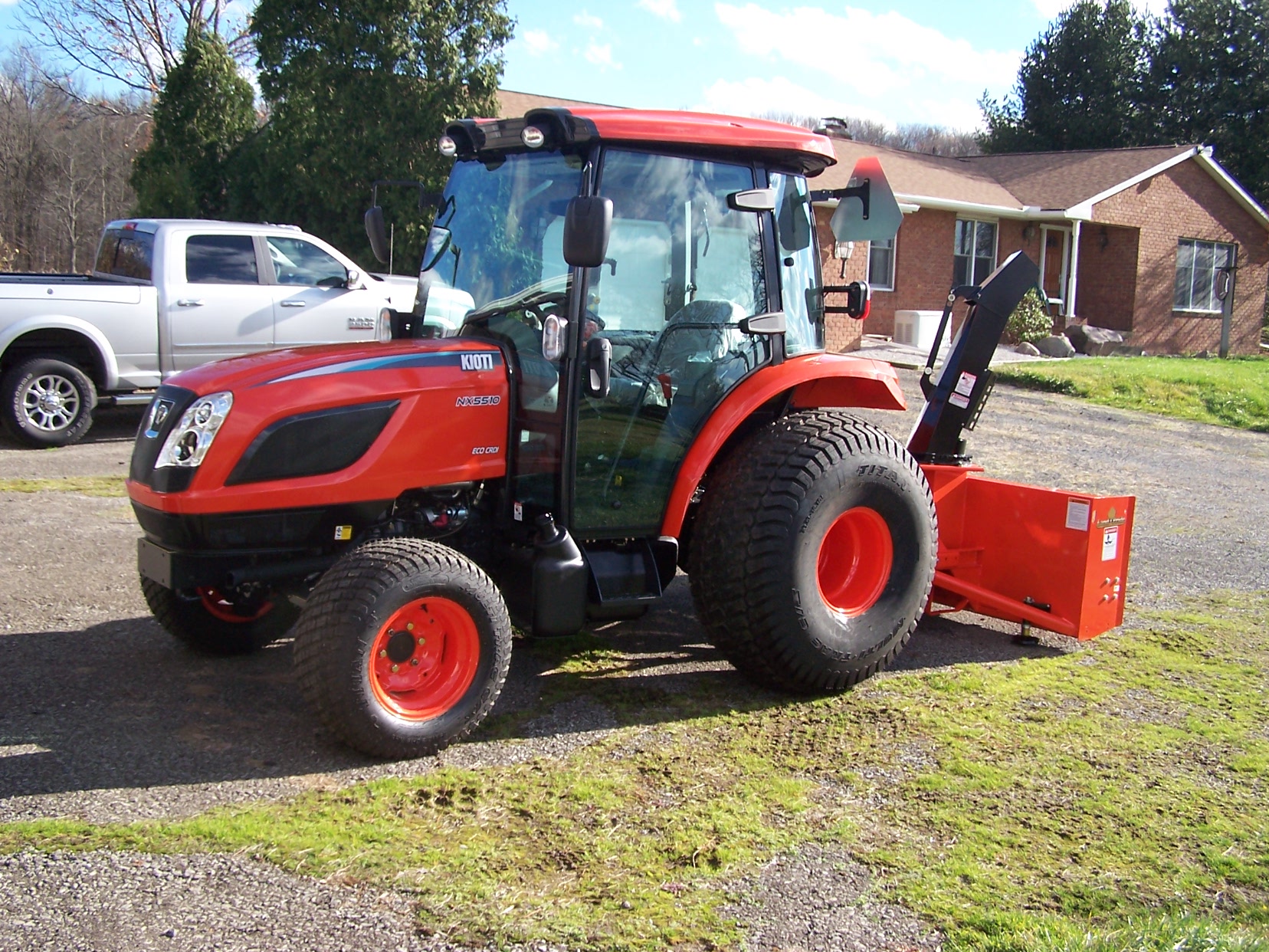

My biggest issue now is tire choice. I wanted turf tires. I saw a set going on another customers ck4010h in their shop, nice tires, look like deep tread snow tires. They were a perfect fit for that tractor. But he said the size they would have for the NX would be shorter and wider.
The tires on the 45 were thinner and a hair shorter than the ones on the 55. I'm concerned about lack of traction and can't figure out what tires to go with now. The tires currently on the tractors are industrial.

I found these pics from another forum member here, hope he doesn't mind me using them. I'm looking at the same tractor with these tires. How do you all think these will be on pavement for snow removal vs AG tires. These are what I want so I'm hoping they would work well...
