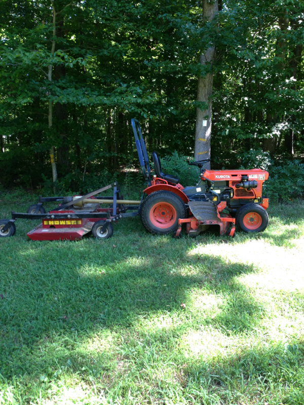

Well he is probably not going to find much of anything at that price. Wouldn't it make more sense to increase the budget a little ( or multiple it by 3 ) and get a tractor that actually does want he needs to do. I have $3,000 in my B7100 without the finish mower.
