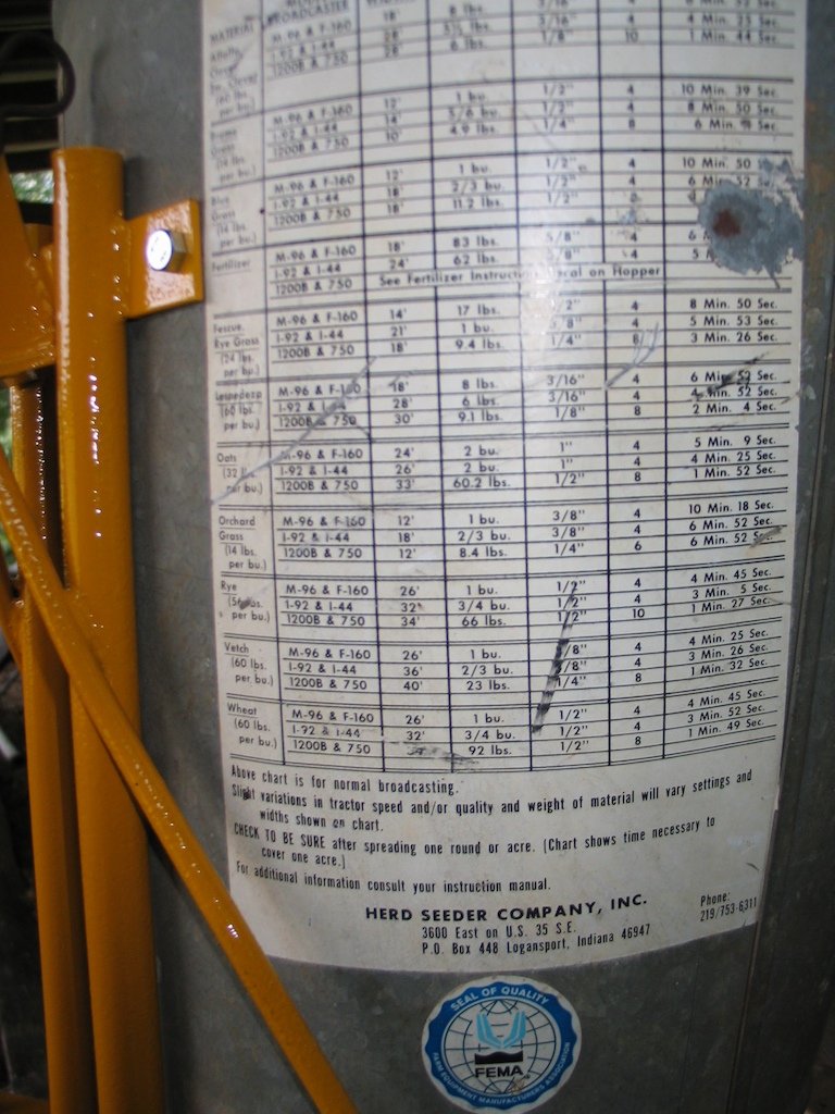

The Herd seeders are far ahead of the crowd when it comes to ACCURATELY spreading small seed. They rank amongst the best in that catagory. Width of broadcast would be controlled by pto speed (and that, by ENGINE speed) Rate (lbs per acre) is controlled by a combination of PTO speed and GROUND speed) My Herd F-160 has a PTO/GROUND speed chart on the spreader. I would assume all models of Herd spreaders do same. (F-160 is a now discontinued model. It's essentially the same as the M96, only with a MUCH larger hopper) I have no personal experience with the electric seeders, but I have heard they do an excellent job.
