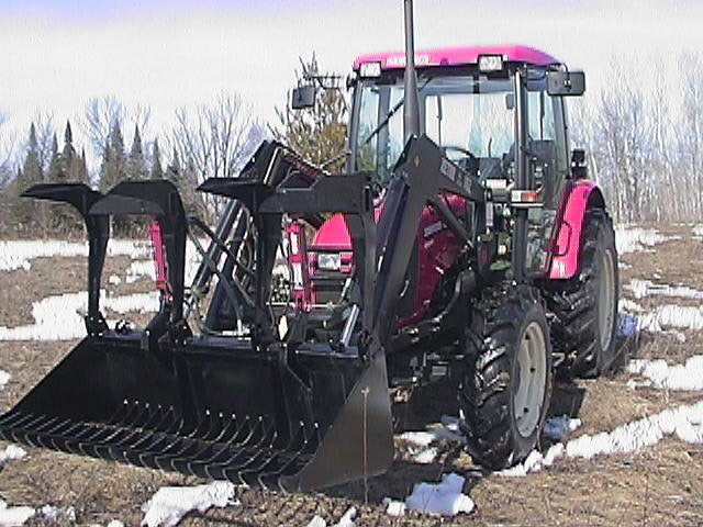

I have about 40ac and eventually bought a utility class 55 pto hp tractor. My concern was stability on slopes so weight and width was more important than max horsepower.
Think thru your tasks a little more. How are you going to feed 4 legged crutters? What about manure?
Haying is another subject altogether; New eq. = $100k + tractor. Old stuff is less reliable requiring repairs, transport, etc. Small scale stuff gets the job done just takes much longer. Weather, labor and product quality becomes a concern.
Spend some time (early) at a local coffee shop, tire shop, etc. You'll find neighbors and sources of info/services to about everything.
Dealers especially ones that don't have time to listen to you are not the center of the universe when it comes to good advise and deals.
In any case you have found an excellent place here to ask questions!
