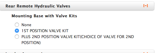

ALSO - can i get some input on which one of these i should get. I would like to have the ability to hook up a 3pt log splitter in the future and I'm pretty sure i need one of these

I don't understand what this is for - PLUS 2ND POSITION VALVE KIT(CHOICE OF VALVE FOR 2ND POSITION)

Like was already mentioned, I prefer the treadle over the two pedal set up but it's what I'm used to.
For a log splitter I would suggest getting a pto pump as opposed to using the tractor hydraulics since it will operate much faster. If you really want to use the tractor hydraulics have them install the power beyond (or whatever they call it) that is used for the backhoe as it is meant for constant flow.
Two rear remotes in addition would also be a good idea in case you get top and tilt or any other rear hydraulic attachments.
