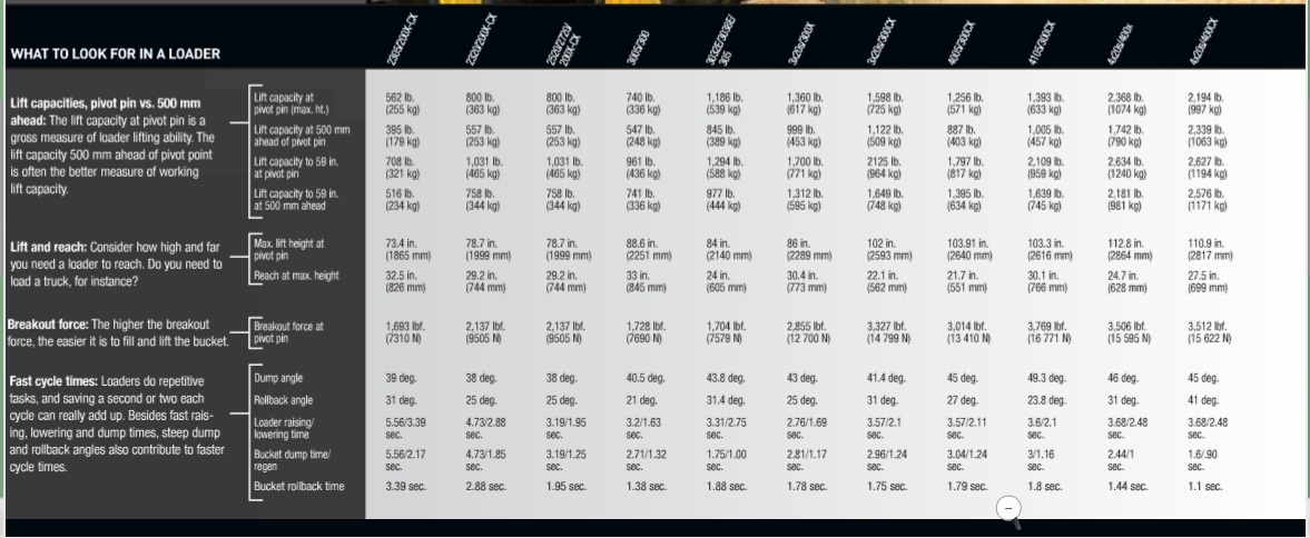

Below are the current loader specs from the latest online brochure. The specs almost look like the 400X loader is a better deal. However, some of the specs do not make sense to me. Such as the at the pivot pin's max height the 400X can lift 2368lbs while the 400CX can only lift 2194lbs, but then at 500mm ahead of the pivot pin, the 400X can only lift 1742lbs while the 400CX can lift 2339lbs.:confused3: Something sounds off as at the "pivot pin" should have more lift capacity than "ahead of the pivot pin" spec. Maybe a mistake was made on the brochure for the 400X and 400CX loader lift capacities.
You could be right there.
I have my doubts that the 400CX would be weaker then a 400X loader. Even IF it was, I would still want self leveling.

Ok, here's the same thing, just a little better quality. I was having a tough time reading it.
The lift capacity at pivot pin is a gross measure of loader lifting ability. The lift capacity 500 mm ahead of pivot point is often the better measure of working
lift capacity.
This was taken out of the brochure. So where the X seems to have a couple of hundred pounds more at max, it says for general measurement the best is the 500MM and the CX has nearly 600 more pounds. Not really sure what exactly the 500MM measurement is though. Seems like the CX either has it in everything or it is very close though...
That is why I think the specs are off on the brochure. The pivot pins should always have the greater lift capacity, which is the marketing fluff number. The real measurement is the 500mm, which is lifting from the bucket - 19.7" from the pivot pins. The breakout force on the 400CX is low though; even the New Holland 250TL loader had more breakout force at 3540lbs on paper.

Spillage is related to roll back angle. In fact, it's easier to manage spilling with a self leveling loader because as you raise and lower the bucket it stays in nearly the same position so you don't have to keep adjusting it.
The 400cx has an excellent lift capacity to shoulder height but it decreases at max height per the spec sheet. That may have something to do with mechanical advantage as the loader goes higher. The specs may be right.
