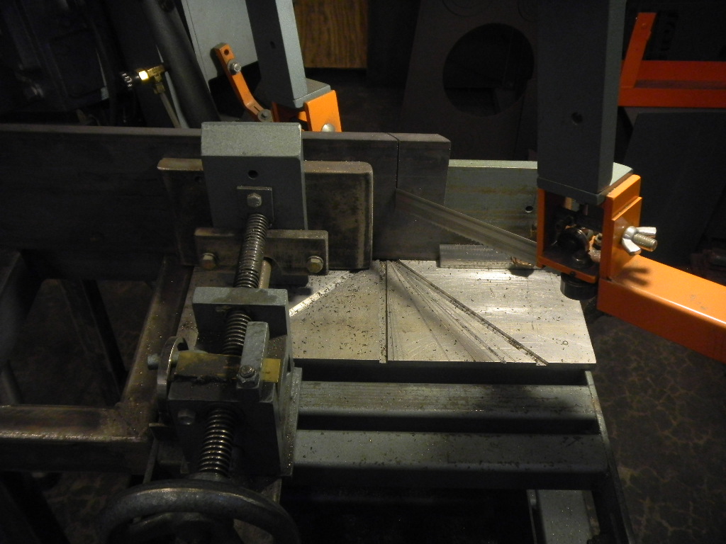

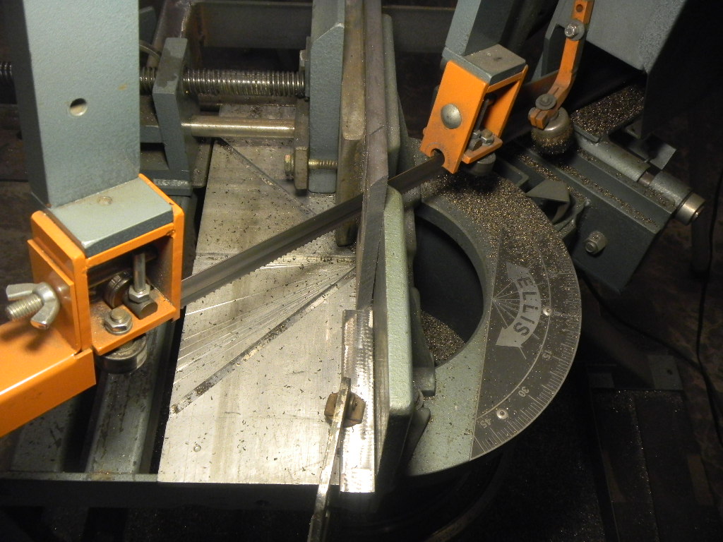

To easily make a bevel, cut the plate at the bevel angle and flip one piece over. Saves a lot if grinding and ensures a perfect bevel.
   / Buying steel for coupons #25
A band saw will cut bevels fairly easy. :D
Exactly! That's what I was trying to describe. You have no idea how many coupons I cut at 90 degrees and then ground a bevel onto before I thought of doing it this way.
