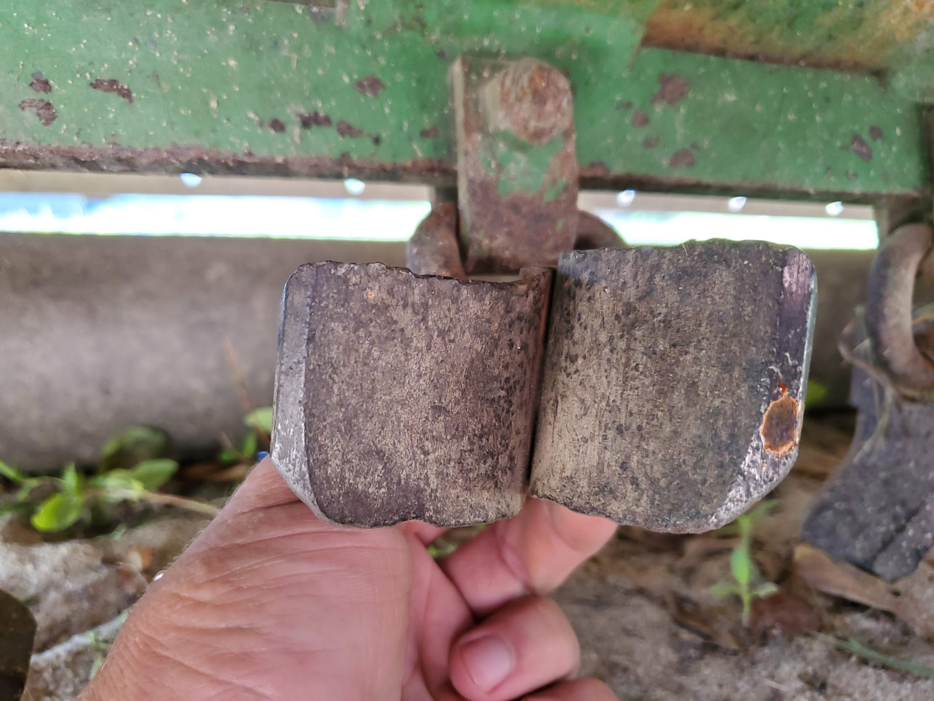

What blades would be best in the future for replacing these? I may start keeping an eye on ebay for auction-style listings for new blades. They are pricey! I'll be sure to inspect the blades CLOSELY next time I purchase a flail.
[edit] For clarity, the blades would be for future. I agree that they have a good bit of life left in them. If they continue to cut the way they do now, I don't even see a need to sharpen them.

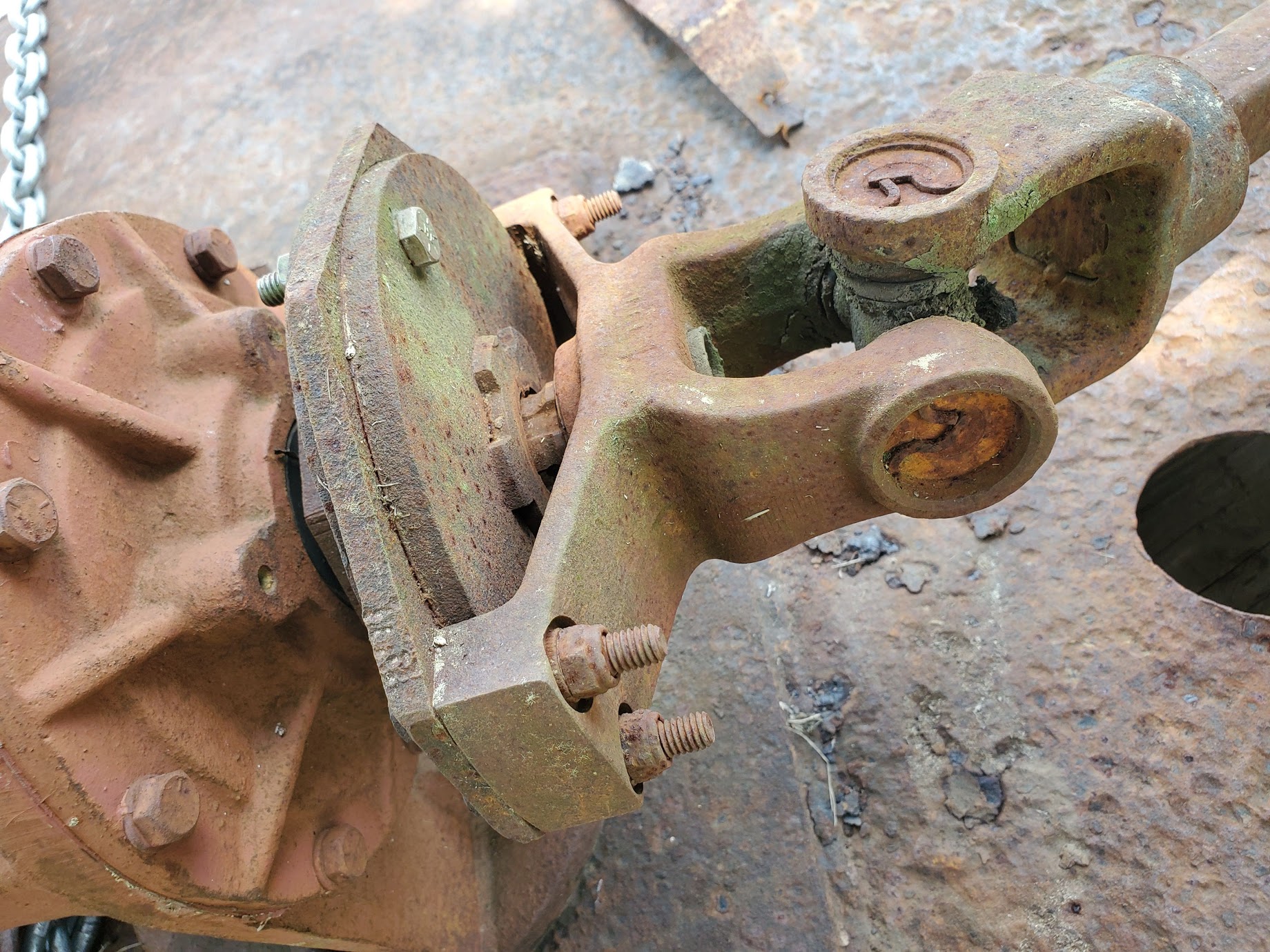

One last thing - What would I need to do or buy to get the clutch for the bush hog back to operational? Or is this supposed to be a shear plate?

Those knives are reversible. When one side gets dull, just flip them over. And you can sharpen them if you don't wear them out too much. The ones that were on my Alamo that came from the Illinois Tollway had a nice radius at the corner. Those were beyond sharpening. You have some very heavy duty knives on there. Just be sure you don't overheat them when sharpening them. They shouldn't be too hot to touch when sharpening otherwise you risk changing the temper if they have been heat treated.

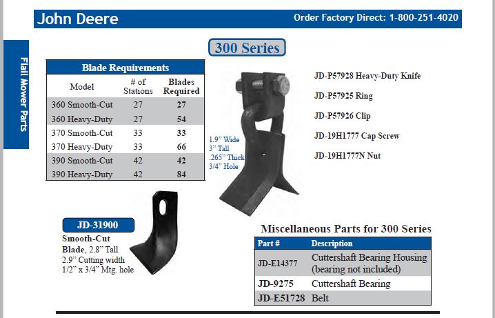

Here is a clip from the Flailmaster catalog for your mower.
It appears you have the heavy duty version. I think the only difference is the knives. You can likely switch to the smooth cut knives if you'd like. Flailmaster is still fielding phone calls and selling parts, but from what I understand they're not making any right now. Give them a call to see if they have parts for your unit left.

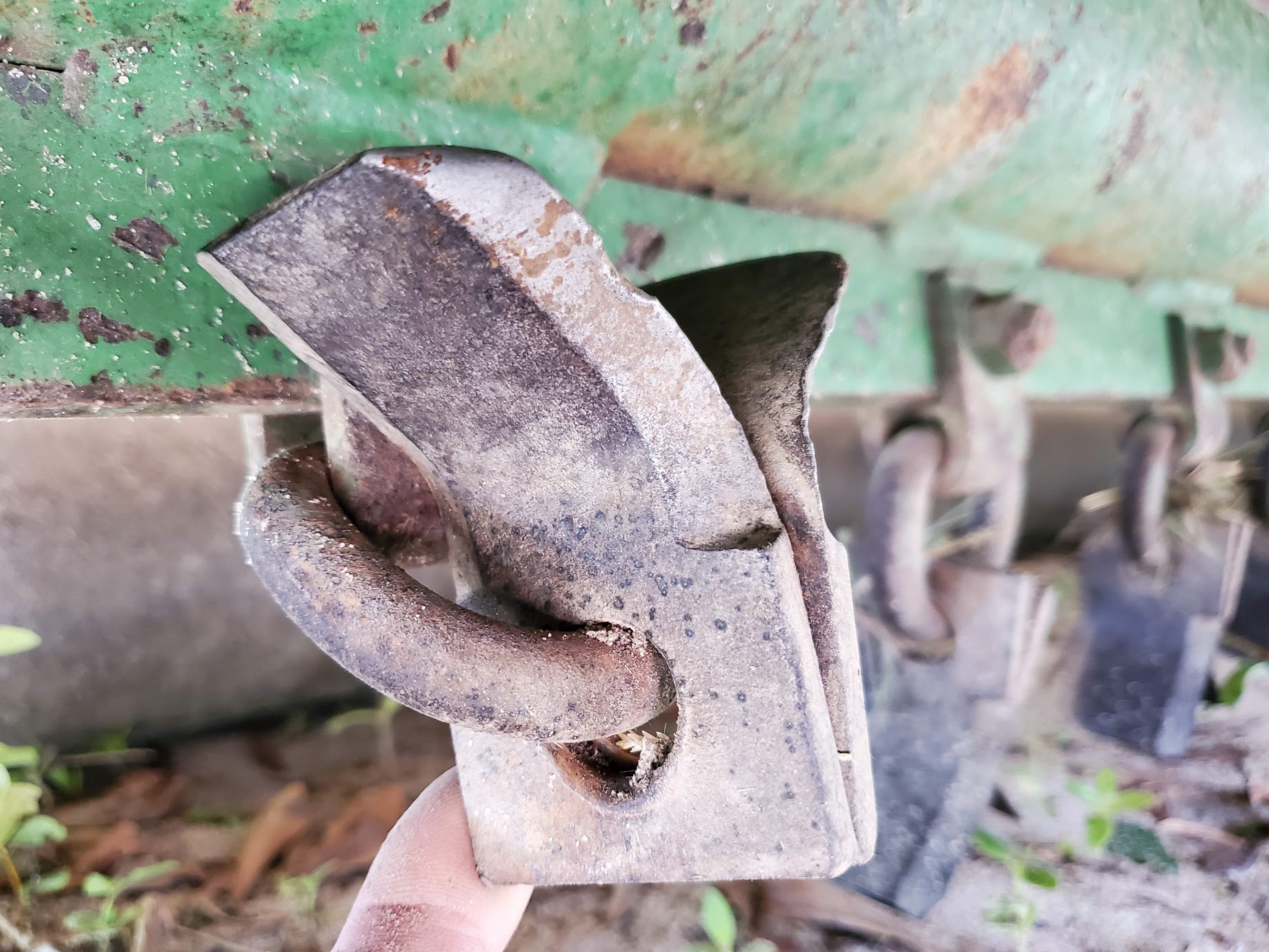

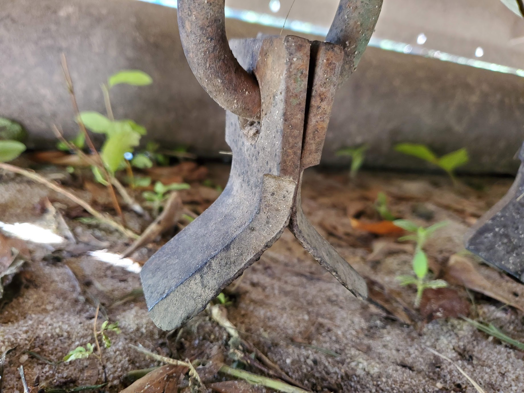

Here is what the blades look like. Should I consider flipping them, sharpening them, or leaving them?
   / Buying used flail mower (JD or Ford) #27
I would sharpen the non-radius edge and make sure that edge is the one cutting the grass. I'm not sure which way your rotor spins, but I'm guessing the edge with the radius is the edge currently doing the cutting. The blades don't need to be razor sharp, just not beat up and dull.
