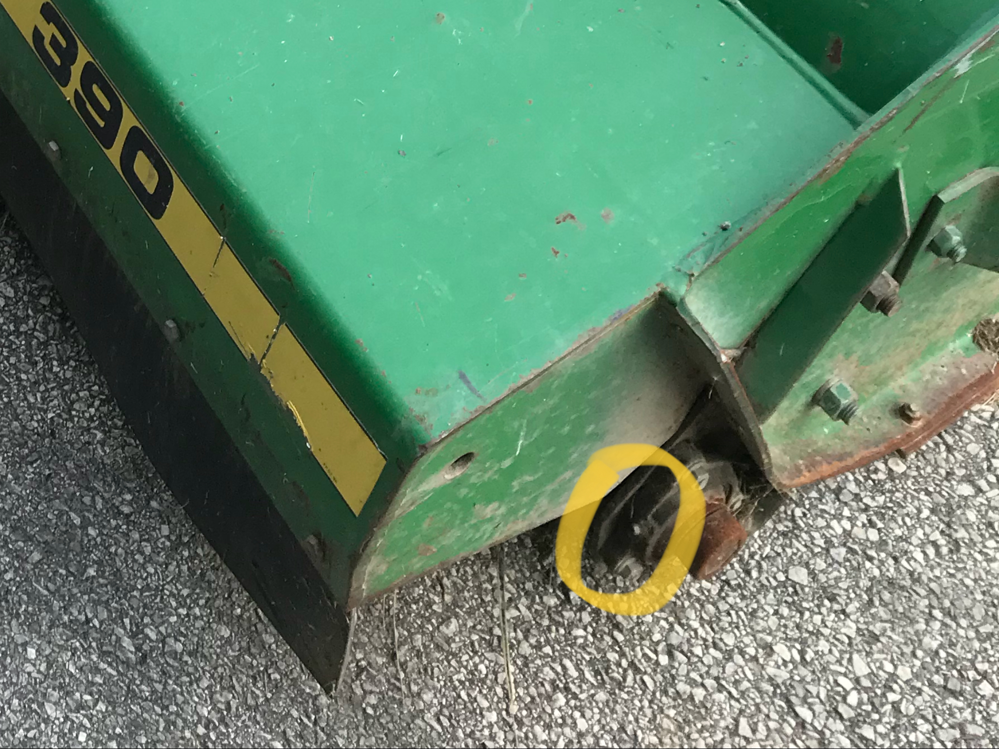

I have owned my 390 since it was new sitting on the dealers lot,,
There never has been a grease fitting on the rotor bearings,,
There is a grease fitting on the roller bearings,, I think that has grease fittings, because bearings HATE to turn super slow,,
You can see the roller bearing grease fitting in this pic,,
   / Buying used flail mower (JD or Ford) #38
Mine is in the yellow circle

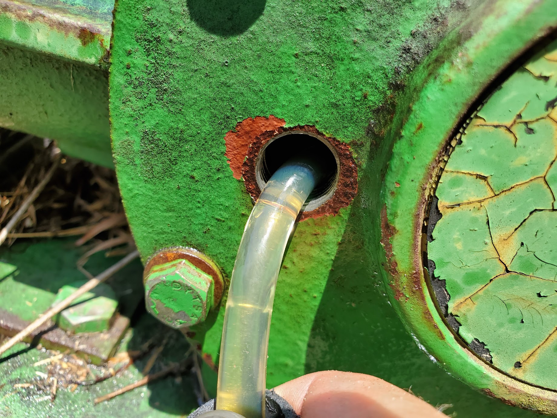

In other news I mentioned previously that I suctioned the old gearbox oil out and replaced it with new. It was pretty nasty.
The oil in the tubing pictured below was run in the gearbox for an hour and was still quite hot. I replaced the gearbox with new fluid afterwards.
I'll likely run this second batch of oil at least a couple hours before I switch over to synthetic.
