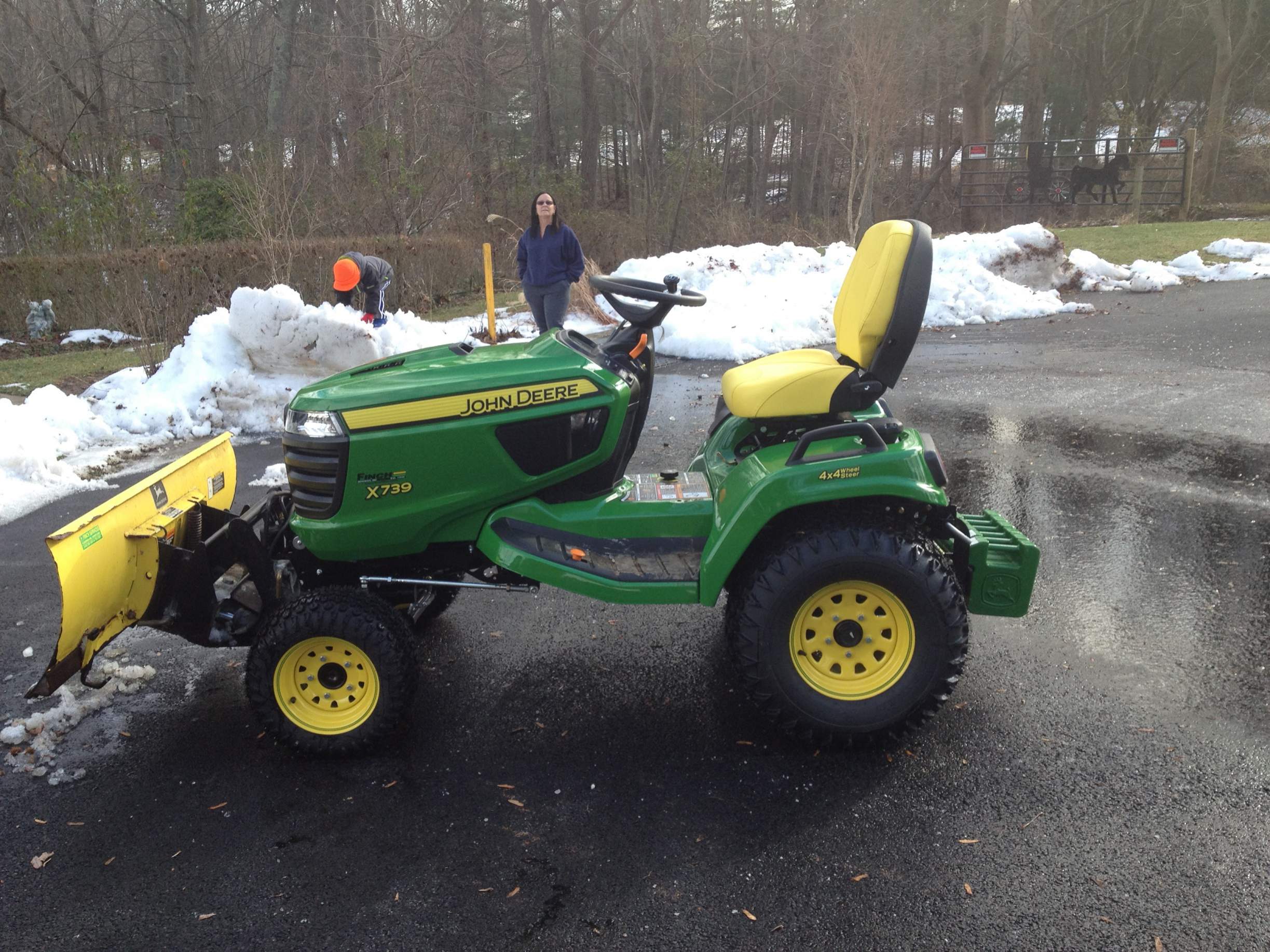

Tractor delivered yesterday. Real nice! However, my old 54" snowblade from my 425 will not fit without hose extensions and right angle adapters. So, calling for more snow today and no parts to fix it.
I did try out the tractor in the snow. Outstanding traction. Went right up my snow covered steep road without slipping once. Of course, I had 250 lbs of weight on the back. But no blade on the front:( at least not yet.

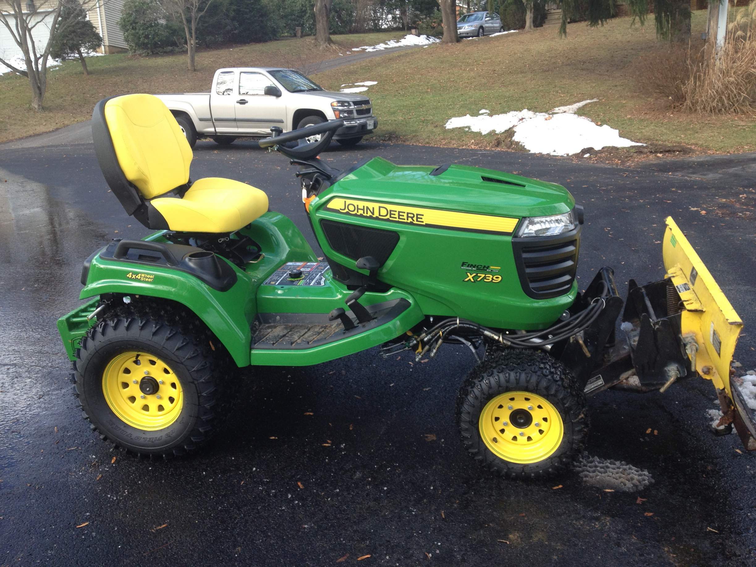

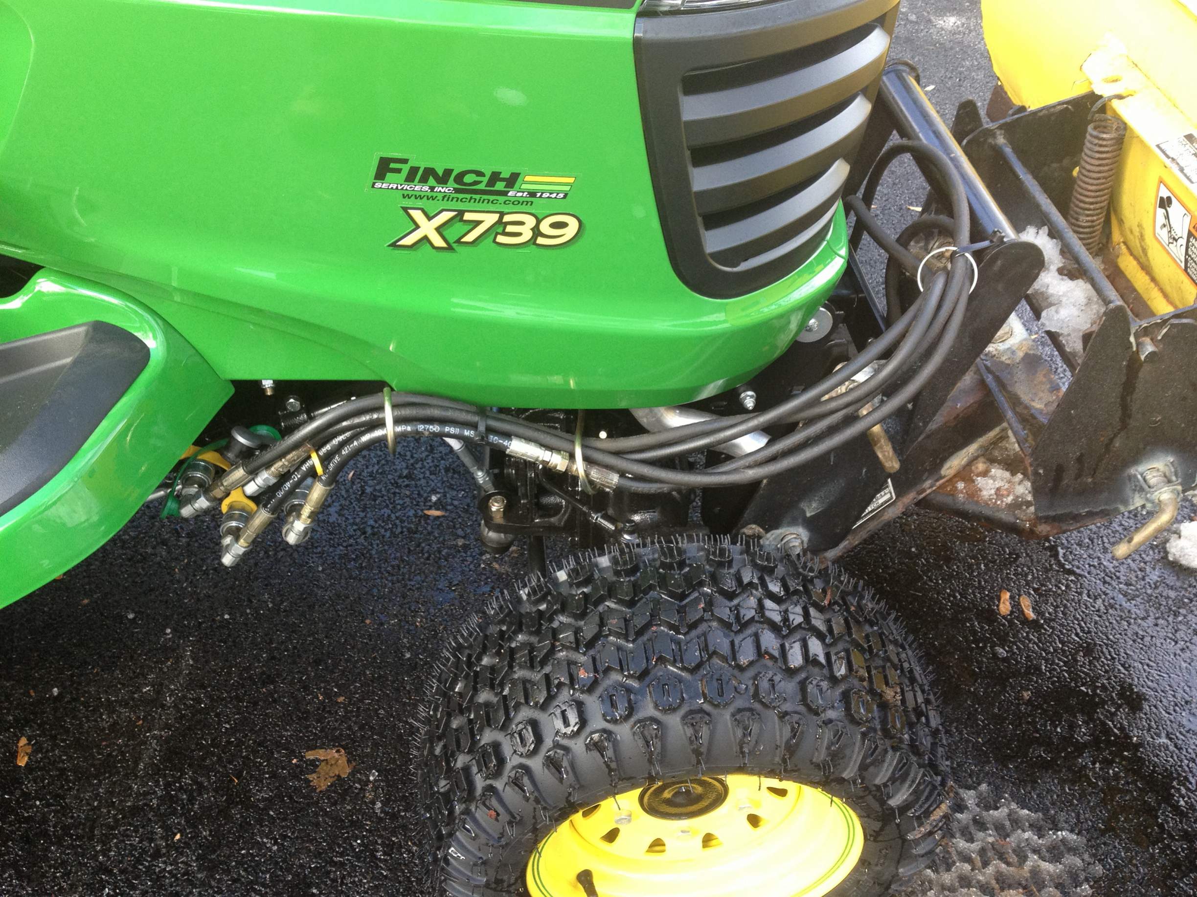

Well I got the parts I needed to fit the old style front hitch to my new tractor. Basically, it's two short M-to-F hoses, 4 right angle spindle adapters, and the 2 guide hook thingies. I'm posting this mainly to help others, as I could not find a detail of the retrofit. Attached are two photos of the retro.
Hardest part was attaching the front most guide. I could not find instructions that made it clear as to where to attach it. An old kit parts lists called for using a 1" bolt only (no nut). So this was a "clue" that it used an existing threaded hole or nut to mount. After searching around for several minutes, the only threaded location near where the guide is supposed to go was the clip nut used to hold the muffler shield. So I proceeded to try and attach it there. After much cussing, the recommended bolt is just slightly too short. So, back to the store I went for a bolt about 1/2" longer. Once I had this bolt, it went right onto the clip nut. I'm not 100% positive this is the right place for it, but I could find no other. Seems to work. Though I wish the hoses were further from the exhaust. I think they are OK anyway. Don't seem to get hot. IMG_0063a.jpgIMG_0065a.jpg

I don't know if this help you any it shows my hoses.

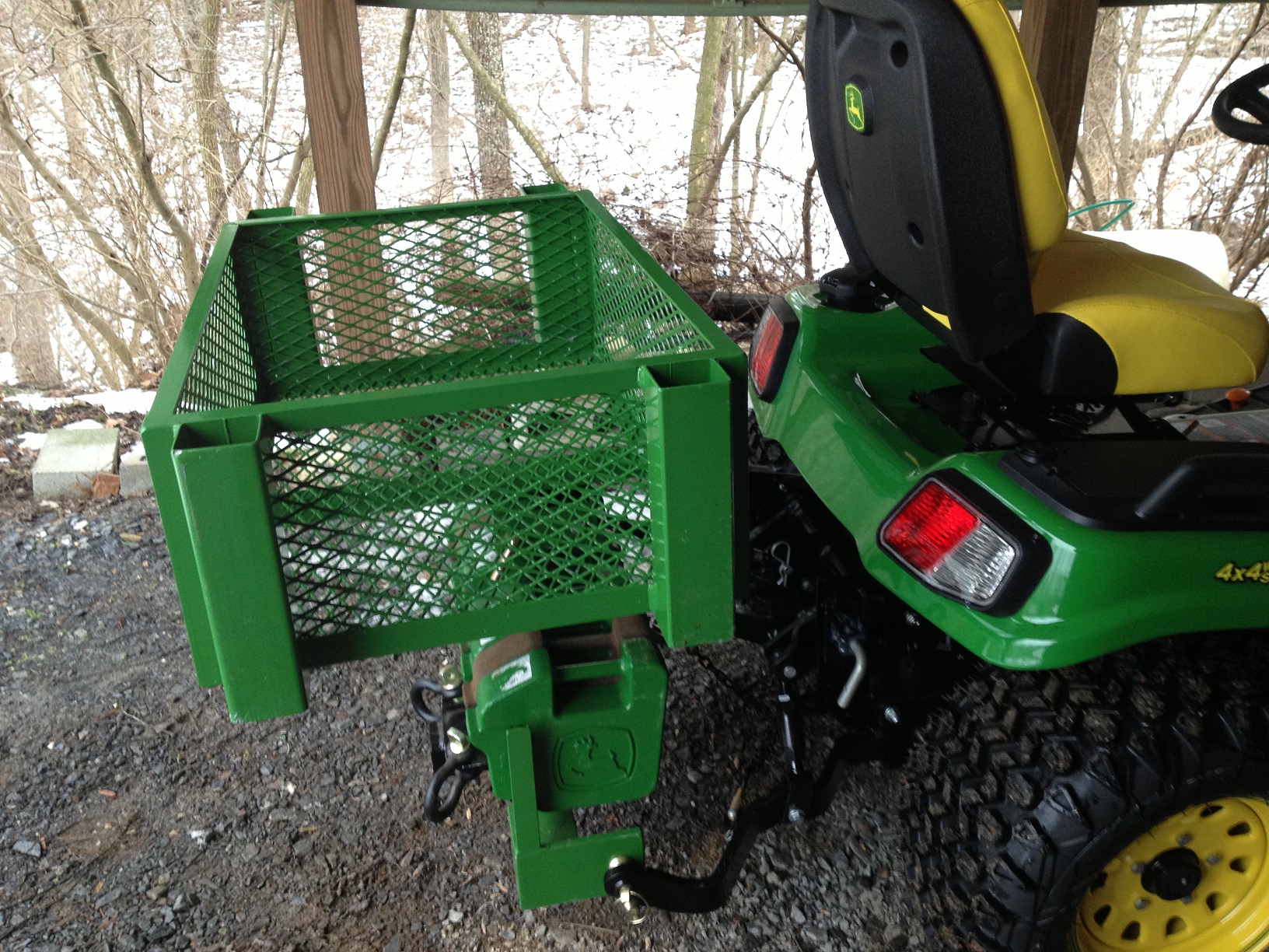

Installed 3PH and added a Omni transformer and basket.IMG_0082_sm.jpg. More photos over in attachments. Total weight with suitcases and basket is about 500 lbs.

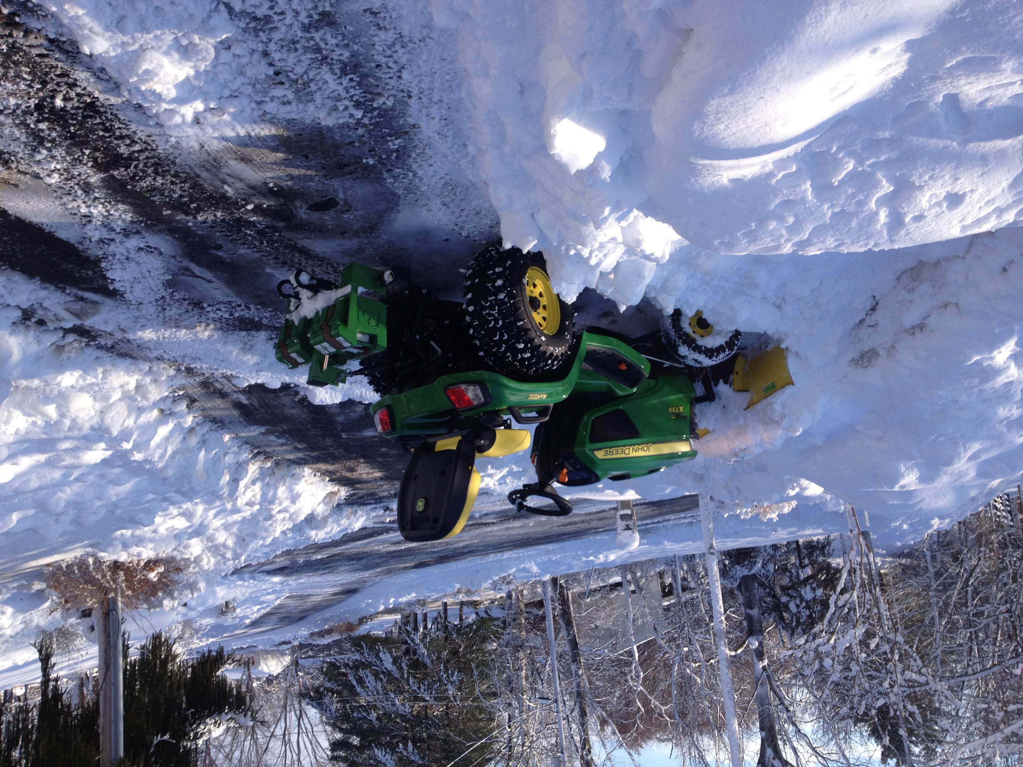

   / buying x739 #40
Wow, that really holds the ground!
