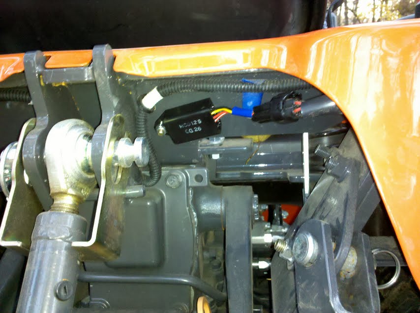

Problem Solved and it was my fault. It was the OPC Timer PN TD060-30500 65.00.
The OPC timer is a electric delay or buffer, It's designed so if you hit a bump or lift off the seat momentarily the machine doesn't cut off.
I had moved my lift arm on the right side up even further and zip tied it in place. I was having problems with the lift arms interfering with the tow behind trac vac I was using to pick up leaves. The lift arm had been shoved into the small box/relay and crushed it. 65 dollars and 20 minutes later I was back in business. I had managed to rig my neutral safety switch so I could drive while the safety switch thought I was still in neutral.
I'll post a pic of the little box later. Thanks for all the help.

And - 2nd to "please post pics". That will help the rest of us to better learn from your mistake.
/ BX 1860 died #33
Ouch!!!
It sounds like you need to remove
the lower link arms while using the
Trac Vac. :cool:
