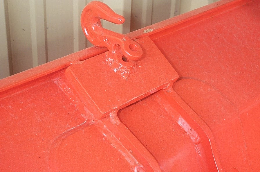

So, I'm still frothing at the mouth for a BX 22. Was talking to a dealer yesterday about bucket hooks. He stated that because the BX 22 has a single hydraulic cylinder centered on the FEL bucket, he recommends that you only add a single hook on the bucket, also centered. His logic was that it would prevent torquing the bucket with uneven loads, which might occur if you had 2 hooks (one on each end).
While this seems logical to me, I wonder if this is really good advice or if he was just blowing smoke with an uninformed tractor neophyte.
What say you, the wise and experienced BX owners in TBN land?
   / BX 22 Bucket Hooks #2
I agree with that. Also, you could easily tip yourself over if you lift anything from either side. Definately want to keep the weight centered. When you get a little "tippy" to one side, well, that's what everyone refers to as "pucker factor".
There are several post on bucket hooks and pictures of what some folks have made themselves.
If you get a toothbar for the loader you can use that for hanging a rope on for lifting. Toothbars really strenghen the front edge of the bucket.....
But, a hook to the center is the only way to go with a single cylinder. Tom

I, too, was told to have a single bucket hook centered so that it would be lifted with the center cylinder and the load would be even. I have a BX22 with just such a hook and have already used it for many things: pulling logs with a chain, pulling stumps after I have dug them out with the BH, etc. It has been invaluable and i would highly recommend having one on your BX!
   / BX 22 Bucket Hooks #5
Here is a pic of the single hook that I welded on my BX2200 bucket. Hope this will help you with your plans.
   / BX 22 Bucket Hooks #6
I HAD THE DEALER WELD ONE ON MY BX2200 AS PART OF THE DEAL. NOT A BIG EXSPENSE TO THEM. IT IS A SINGLE HOOK IN THE CENTER. A MUST FOR A LOADER. I USED MY LOADER W/HOOK THE OTHER DAY TO PULL FENCE POST, THEN TO LIFT THE 60MMM TO CLEAN AND SHARPIN BLADES.
