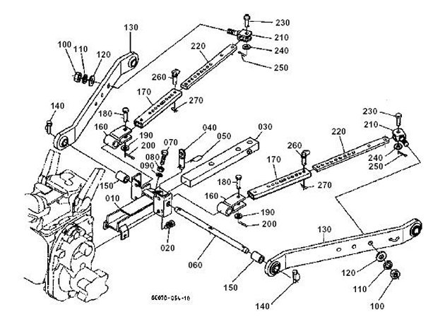

Below are the Kubota part numbers for the two arm pieces you will need for the conversion. Prices were as of 12/22/07 at my local dealer.
2 ea 6C070-65333 Plate, Stab Arm @16.03 ea
2 ea 6C070-65320 Pipe, Stab Arm @16.03 ea
If you choose to replace the welded on attachment at the rear of the lower arm with the pivot type, you will also need the pivot bolt listed below. Stan
2 ea 6C070-65350 Bolt, Stab (pivot) @2.44 ea

Did you get the pivot bolts for the rear? If you did, how you going to hook the tube portion to the front on your BX24, will the parts #160 from the pic work since you have to remove your lift arms when you put on yor BH? Just curious, would be nice if it will work with the BX24.

Yes, I did buy the pivot bolts, but I am not going to use them. I just attached the solid bar to the OEM spacer plate with two 7/16" bolts and nylock nuts (Plate holes need to be drilled out slightly). On the rear, I slotted the tube on both sides 1-1/2" back to allow Them to pivot as needed on the existing attachment tab at the rear of the lower arms and used hitch pins at that point. Using the part #160 in the illustration would make attachment much more difficult than just using the OEM spacer plate. The whole operation took me about 30 minutes to set up and now using the quick hitch setup is a snap. Everything is setup for one size except my auger, which can't be altered, so a simple change of the pin placement will acomodate whatever implement I am hooking up to. I'll add some photos in a day or two, but it is similar to several others in this thread. This does make a very clean and functional setup for the BX series 3 points. Stan
BTW: The item #160 will cost more than both stabilizer arm halves ($38 each).
