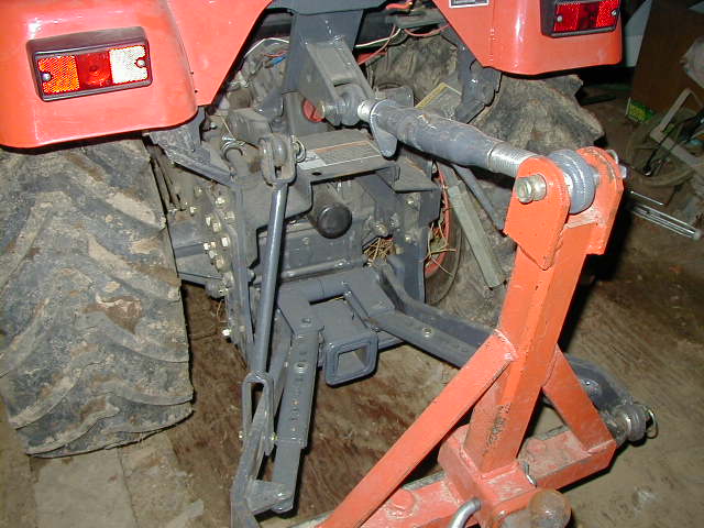

Charliebrn,
I looked at the attached picture of your mod but I'm still unsure of exactly where you needed to cut, grind and drill out for bushings. Would you be able to put some arrows or numbers on the photos?

   / BX 2200 LIFT ARM ADJUSTERS #72
If you are installing the B2710 adjusters on a BX series tractor, you'll need to modify the "female" tube to allow it to slip around the mounting point at the rear of the lift-arms. Those mounting points are roughly triangular in shape and need to slip into the tubing. As they come from the dealer, the flat tubes have a square end, so you need to grind off the side a little less than 2" so the mounting points can slip in from that side. From the pictures I've seen, grinding a little off the other corner is also helpful to keep them from binding when things are spread "wide".

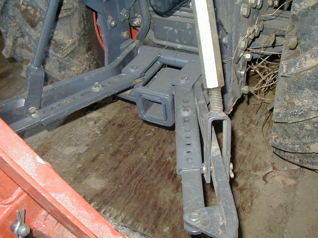

put some finishing touches on the lift arm adjusters (stabilizer links)

had my brother make the attachment for the front of the adjusters, think they'll work fine, as you can see i've been in the woods dragging firewood, note the vines around the right axle

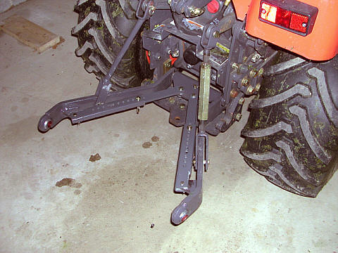

   / BX 2200 LIFT ARM ADJUSTERS #79
I did the deed...see attached. (Finally got them installed two weeks ago after they sat on my shelf for months!)
