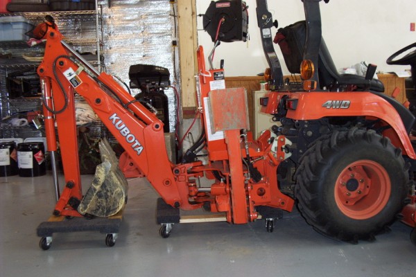

I bought a couple of dollys from one of the box stores, either Home Depot or Lowes that I use for the backhoe. I can move it around the garage to slide it out of the way. I've found it's easier to hook back up that having it on the floor. The first pic it rolling it close enough to hook up the hyd lines.

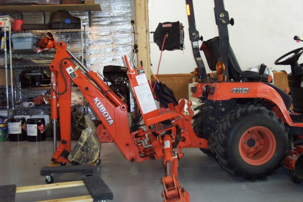

The second pic is putting down the outriggers so you can back the tractor under the bottom hooks, I put the first dolly out first.

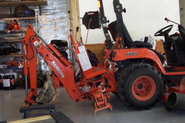

Third pic is using the hoe to push the top into place so it can be latched.

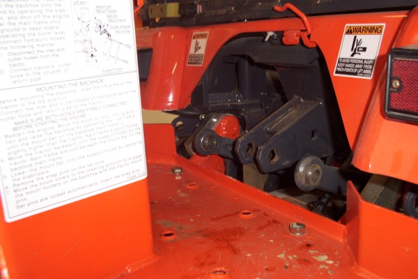

Last pic it the most important. Make sure before you start that the 3 point lift arms are in UP. Don't ask me how I know but if they are down the backhoe will not latch. It will drive you crazy. I remove and re-install the backhoe often and have found this works for me. Cheers, Richard
