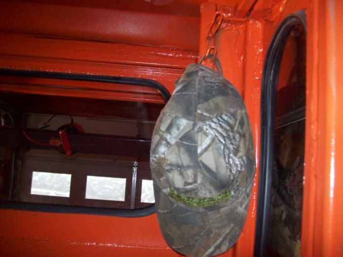

HEY PUSH IN DIRT,
I had a thread 3 pages ago called bx-23 alternator upgrade .Iphotographed and detailed how to do it.Heres a pic of the super modified intricate,special systems ,custom special,dual element ,metal oxide,special mig welded ,processes ,dual purpose ,coat hanger just for you:)
ALAN
