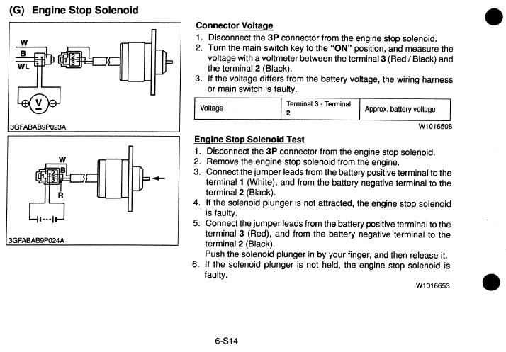

I would be testing the stop solenoid. It either is not getting power or has failed.

So to testing the solenoid as K5lwq suggests.
Connector voltage; same as battery.
Not sure if the diagram is the same as the solenoid for a bx 23 but there’s only a black and red wire from this solenoid and no white, so I didn’t know how to try step 3 and 4.
I tried the battery positive to the red and battery negative to the black and it causes the switch/ button to pop out and stay out for as long as I have it connected and pops back in when I release the connection.
The instructions say to push it in with your finger, but I can’t seem to - it’s really strong.
   / BX 23, sputtering and hard/won't start #23
If I am understanding correctly yours must stop the engine by momentarily sending power to the solenoid when you turn the switch to off. Then it should retract and it is ready to run next time. So there is a timer relay that controls that if I am correct. As long as the solenoid is powered it would keep the engine from running.
The one I posted works the other way. It has a pull section of the coil and a hold section. That is why it needs 3 wires. It needs power all the time for the engine to run.
The fact that yours will run with the solenoid unplugged tells me that it is retracting but maybe the relay is firing when it is plugged up some times. Next time it happens check the voltage at the solenoid before you turn the switch off. If it has power you need to find out why.
