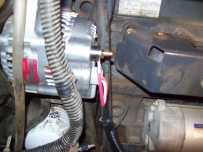

#21
NOWtape off the old wire ends where the dynamo hooked in,you dont use them any more
Hook new harness to starter as shown

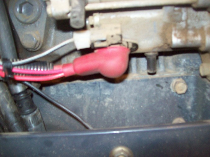

   / BX-23 UPGRADE ALTERNATOR #22
Lookin Good.........
#23
HOok up these wire ends to alternator

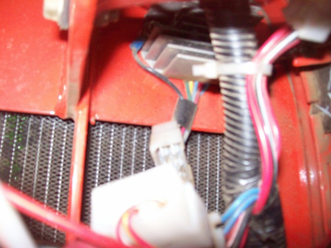

#24
Next step is ya gotta feed them wires through the firewall where all the others go.Unplug that end part,just pay attention which wire went where.It makes it easier to feed through.
#25
....plug it back in on the other side ,before you forget:)

PUT YOUR TRACTOR BACK TOGEATHER YOU HAVE JUST UPGRADED YOUR SYSTEM. I hope ive help aid in the install with an easier description of the directions .SORRY ABOUT THE DOOHICKY AND THINGY AND GISMO:D:D:D
For those of you going a different route,i believe you will need to re wire your tractor a bit..Aregular alternator has all internal components the dynamo didnt.The kit has a 50 amp fuse and holder that replaces the 30 thats there.ALSO that plastic gismo i believe is a rectifier

   / BX-23 UPGRADE ALTERNATOR #28
Nice job Escavader! The pictures were great and the instruction about making sure the belt was on the new alternator pulley before tightening it up is a must. The belt won't fit by the radiator and the pulley wheel after the alternator is bolted up. When I took the old rectifier off, I put the plastic relay up in there and hung it from the one post that most out of the way. You are right about the instructions being bad....just about useless really. I bought my alternator from a guy on e-bay, but he's not selling them individually anymore, only in lots of ten. My wiring harness cost $75.00 from the dealer, so I think you got a good deal on the entire package. I put a voltmeter on my rig, so now I can watch that new alternator pump juice while I have all the lights I want on. Good project! Dyer, retired
