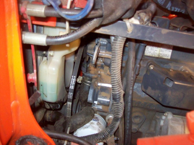

IVE been researching calling different dealers and driving all day ,heres what ive got
this pic is of my current alternator.It is not referred to as that ,they call it a dynamo

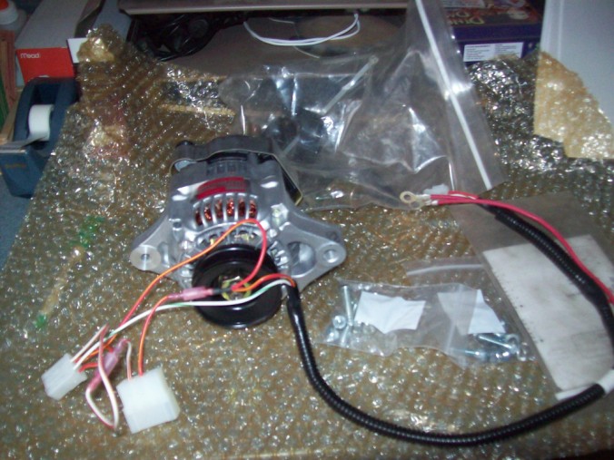

Iended up at my dealer ,after going to parts stores,alternator shops,and calling dealers state wide.The lady at the counter showed me the two optoins,both that they had in stock.One was my current dynamo-,the other actually looked alot different ,actually looked like a car alternator.Isaid that cant be it,its not the same.Then the parts manager and service manager got togeather and went into the salesmans office and found an alternator kit that was not available in the parts computer,:confused:He said i think we have one:)He got CINDY[ the owner]and they went up in the attic overhead of the garage and found it.She had ordered it for a customer a few years back and he never took it.Now get this;it was the same alternator at the counter that lists alone for 315.Igot the whole kit bolts,bracketts wiring harness,the works for200 even[i dont know what the kit usually cost at todays pricing]:)Heres a pic of the kit and im gonna show pics of the install part number bx7310a fits all bx tractors im told.A BIG THUMBS UP TO OSGOODS for going the extra mile,and having lots of parts available

That is the very same alternator kit I had installed on my 1830
Much better than that OEM junk that came as standard equipment
You got an execellent deal

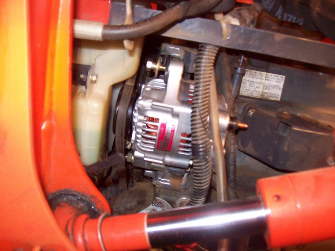

OK IM AS HAPPY AS A PIG IN MUD.It startes right up,and i turned every thing i got on on the tractor not even a wisker of tone change with the heater on high:):):)
FIRST THOUGHT The directions suck swamp water.so im gonna post my pics
Job 1 unhook negative battery cable
job 2 take off grill guard[if you have one],remove side panels
JOB 3 REMOVE OLD DYNAMO 2 bolts

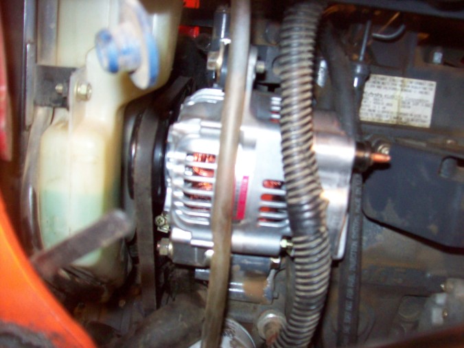

Next you have to choose from the kit,which new tightening bracket you need.Itook the one from the bx22-23.Remove the old[2 bolts]install the new.GET the bushing and new bolt from the kit for the bottom.Ibelieve i used an old one for the top rough in the alternator.Before you tighten ,make sure its on all the pulleys.If its off on the bottom one ,its easier to crawl under and slip it back on,tighten it up according to your owners manual.
