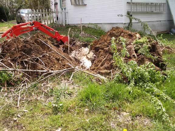

I've dug quite a few big roots with my BX, I am no newbie at this. When I bought the B3700SU the salesman (from whom I purchased my first Kubota in 1985 and three others subsequently) suggested that I clamp the L3700s FEL down on the loader of the BX-24 and the BX would not get pulled into the hole.

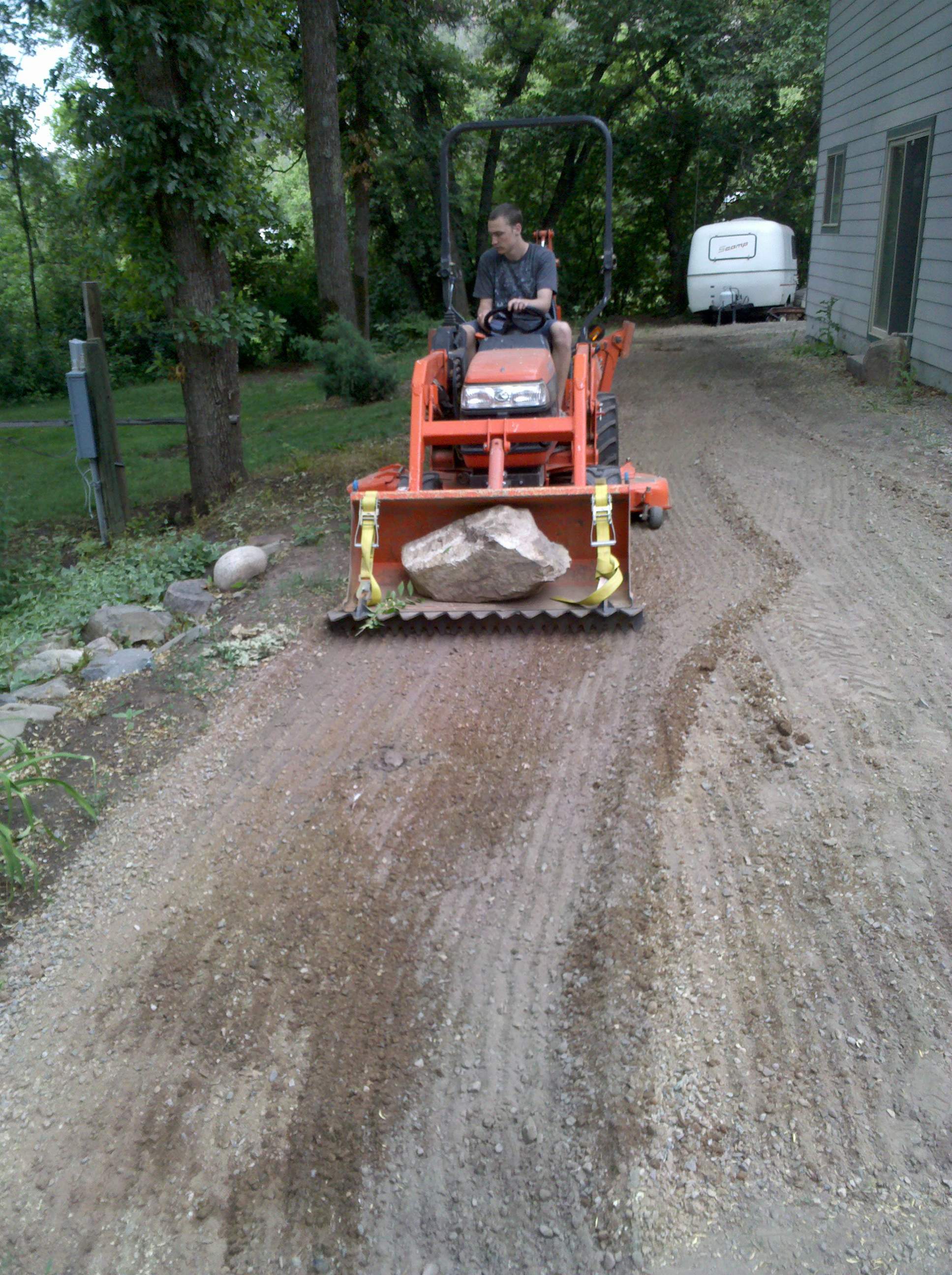

I have the ratchet rake on my front bucket and put a large rock in it. The teeth dig into the ground and it anchors the front much better. The BH can still pull the machine around, but every lit bit helps in anchoring the machine.
The rock makes the ratchet rake work great in the "float" position for manicuring the drive.
