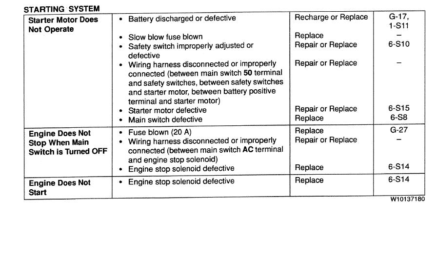

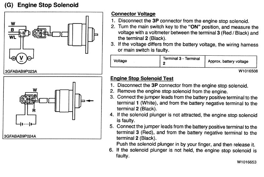

The attachments are from the BX23 WSM w/the D905 engine, the D902 is similar.
This is a common occurance w/BX's that have electric devices wired into the switched "hot" connector under the seat, i.e. ROPS lights, strobes, 12V aux power etc. Seems this switched hot connector shares the same fuse as the fuel stop solenoid.
Good luck, anythings possible including a bad stop solenoid but I say you've eithe rgot a blown fuse or loose connector. Theres not been many bad solenoids reported here but there have been a great many blown fuses......
