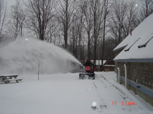

Sounds like a blower would work. My drive is 200' long, going uphill, but the lower "turn-around" area in front of the garage is easily 35' to 40' wide. I also used to use an 8HP walk-behind, and ended up moving the snow 3 times in the wide area before it was over the bank... an 8' high wall would have been impossible. The GC2310, however, with the 2360 front blower, throws easily 40 to 60 feet away, and I often hit the trees 10 to 12 feet up- but I have no walls to contend with.
In the photo below, the snow was not very deep, only a few inches, but was slushy- you can see the arc. I also do the top of the drive --side of the dirt road, really-- and am able to blow the snow across the road and up into the trees on the (uphill) bank on the other side of the road. Very impressive, to me!

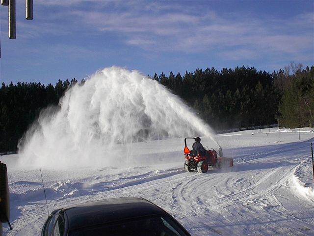

I totally disagree, and I get a lot of snow as you can see from the picture below. A snowblower can move hard packed snow as well as front end loader, because they both cut into the snow, they don't push it.
The disadvantages of the rear blower are well know, primarily having to look over your shoulder for long periods of time. It is hard on the old neck. A cab makes the whole process more pleasant. The rear blower is cheaper because you don't have to buy the undercarriage.
I probably have to go out and snowblow 30 times a year and it takes about 45 minutes each episode (450' by 20' drive and walkway). If we only got a little snow a few times a year, the rear blower would be OK, but if you get serious snow the front bloer is great. I can't think of any situation in the winter where I said to myself, "I wish I had the front end loader on."
Kubota B3030 snowblower in action
