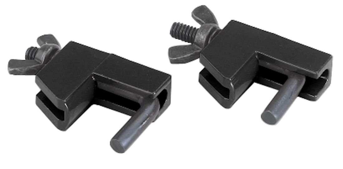

I've used small vise-grips to clamp the lines with no problem. These days I find something like this a bit handier.
https://www.amazon.com/gp/product/B002YKHRUK/ref=ppx_yo_dt_b_search_asin_title?ie=UTF8&psc=1
