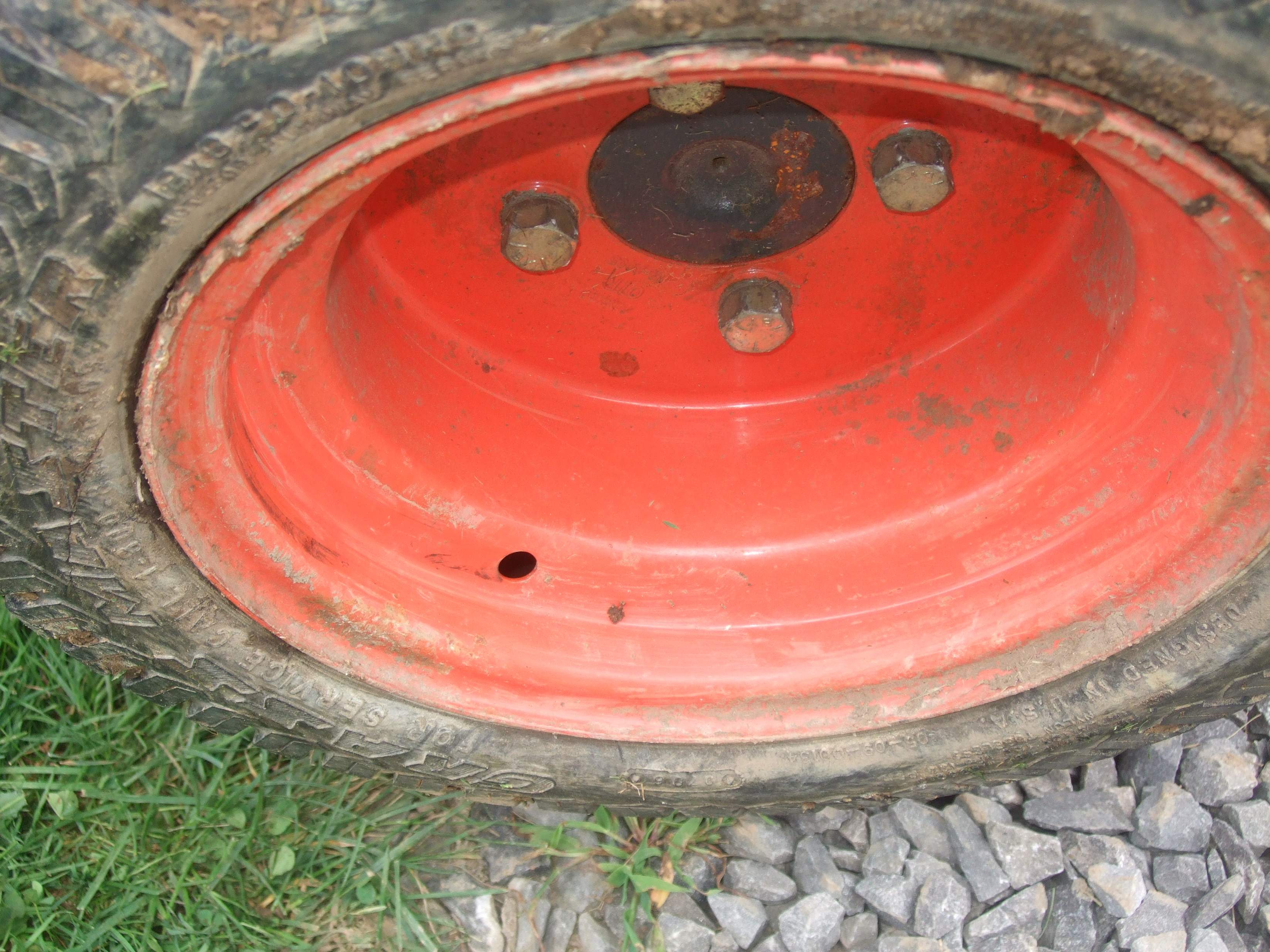

yup.. it happened to me too. my front tire stem got caught on a tree root when diggin out dirt. I was able to limp home with FEL as my sled. My rears started leaking rimguard thru the stem and the metal screw on part for cap, but I was lucky that day. Had my BH on at the time and used that as a jack and was near a shed with tools.

Hate to be the saftey police on this one but if you are going to weld a guard around the valve stem remove the tire 1st other wise we may be reading about you in the saftey section:(.
Tire Explosion - YouTube
Personally just foam the tires and you will never have to worry about it again.

I messed up the right front valve stem on our M8540 the first week we had it. I read a pretty long thread on welding stems etc., but never did it. As mentioned by Gordon Gould and Powerstroke444e, there are dangers if done improperly.
I haven't put any on ours, but may if I rip another one out while it is down and off the tractor. There are several threads on here worth reading about it.

By the way my 2011 B2920 came with stem protectors on all four rims,,,,I spec' d the metal stems
   / BX-24: Something ripped the valve stem off while clearing brush #17
Put the Surevalves on mine a couple of years ago...great product, much easier than welding on a collar and very rugged.
