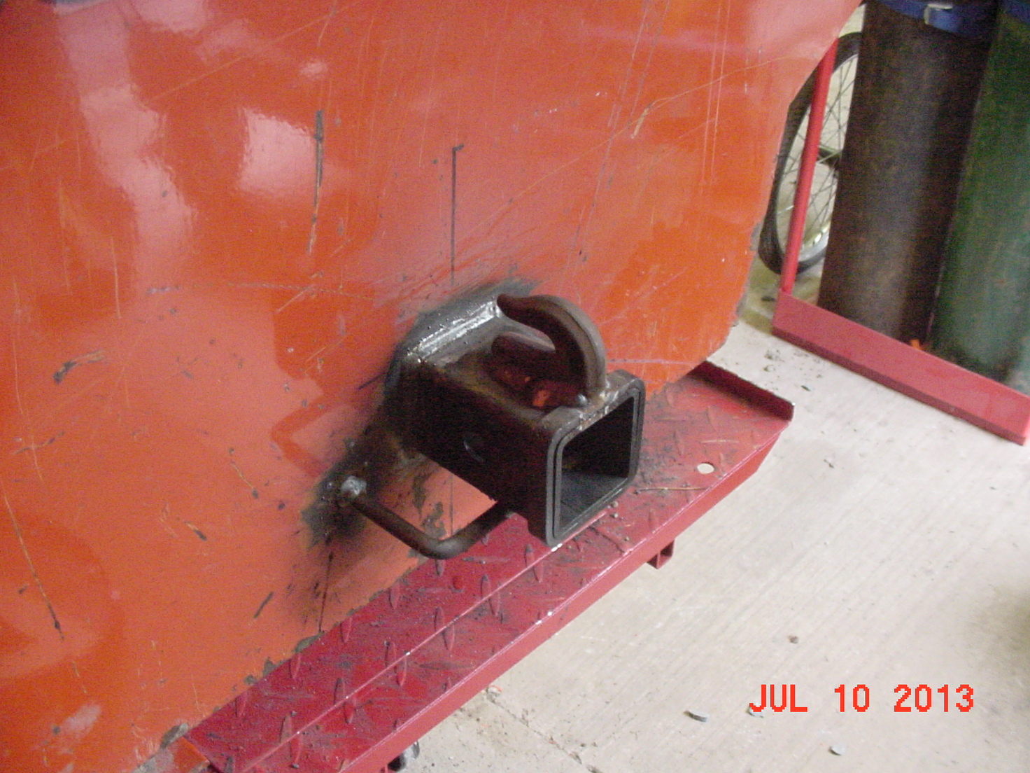

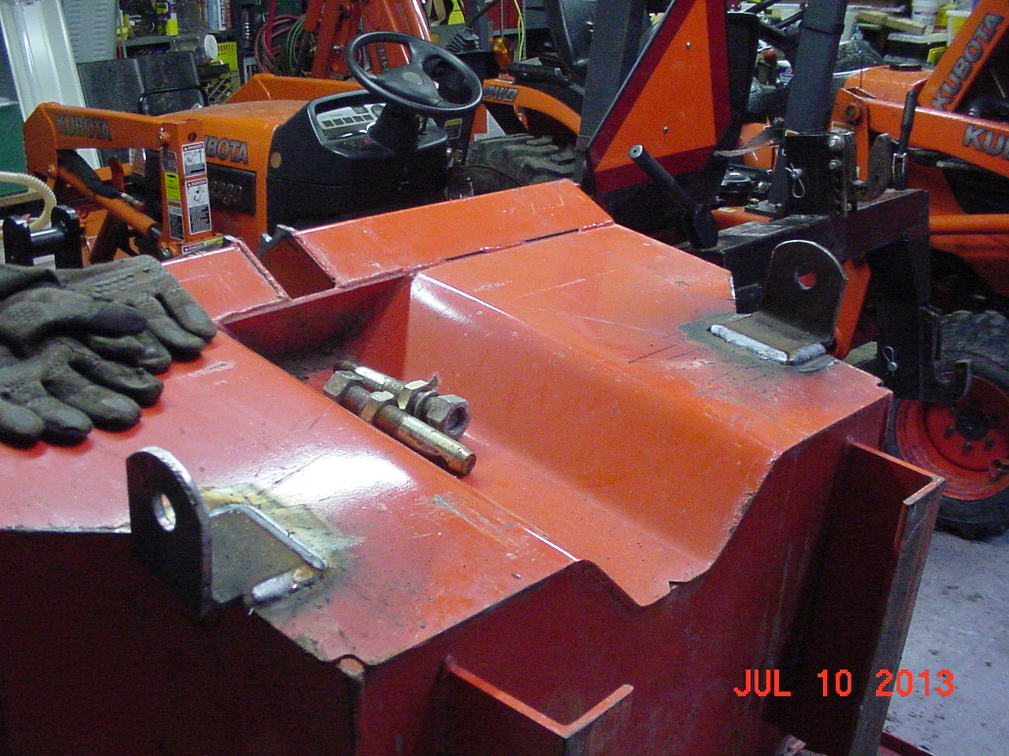

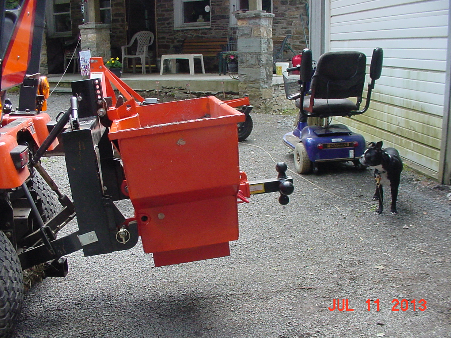

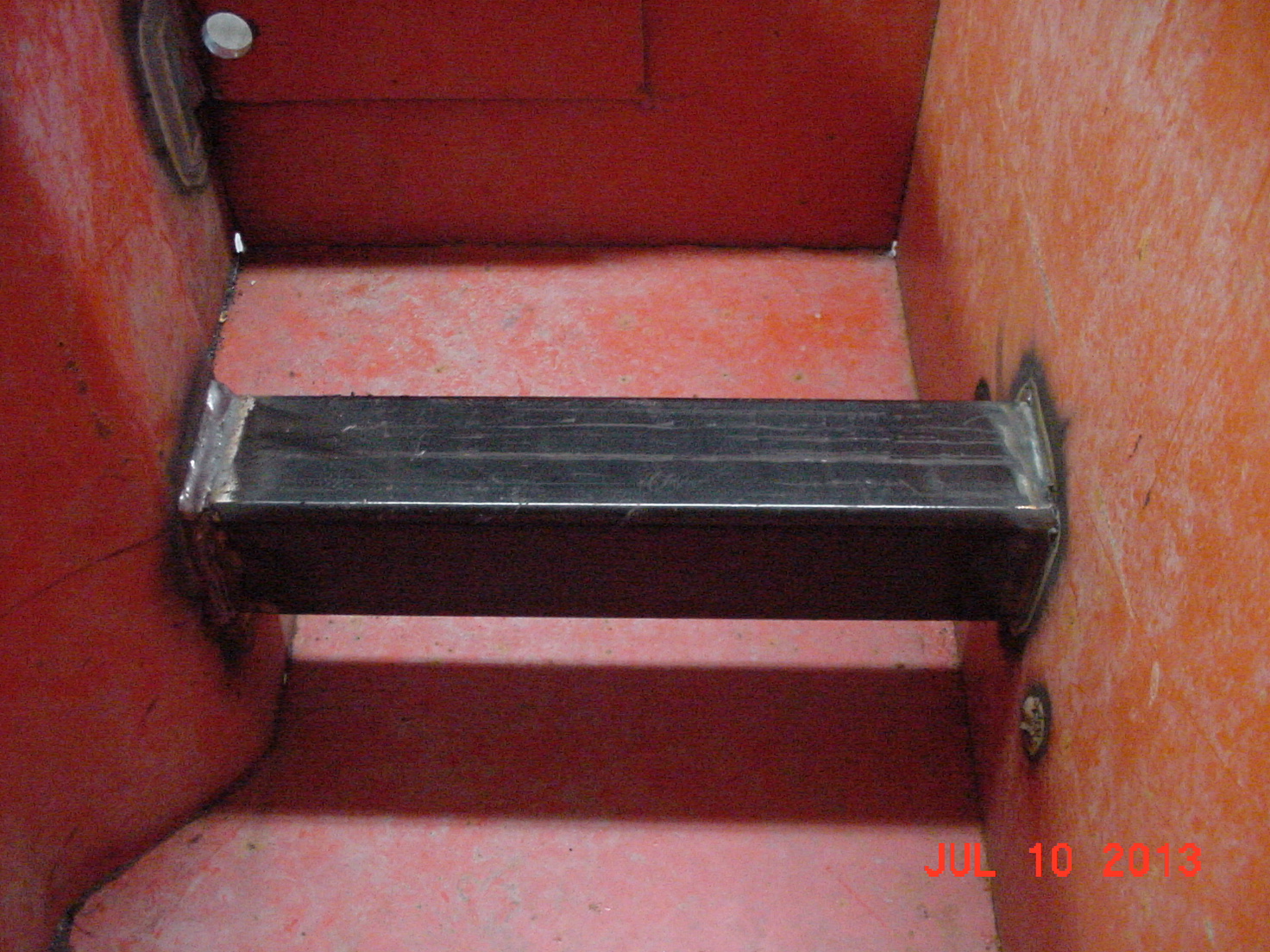

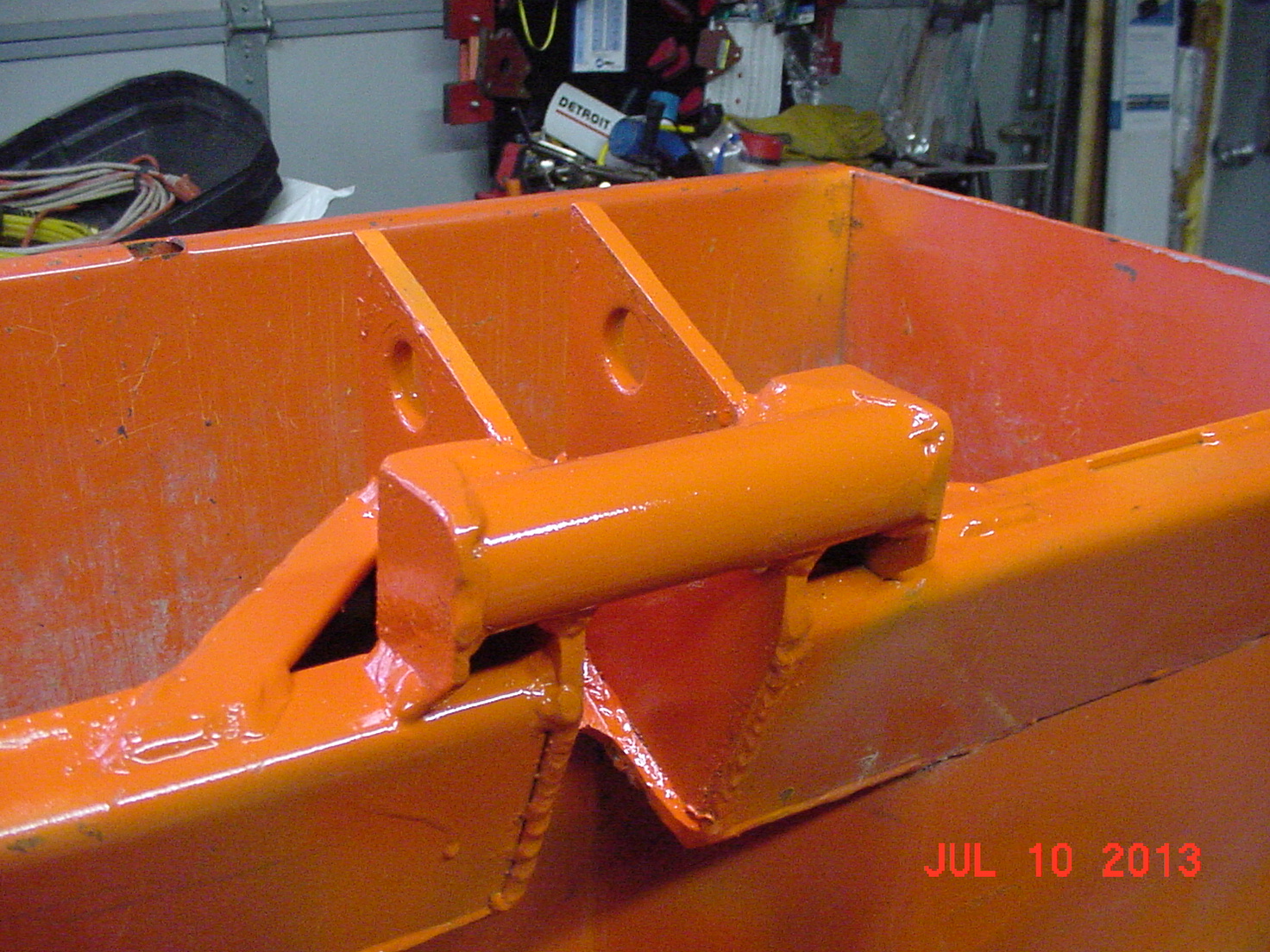

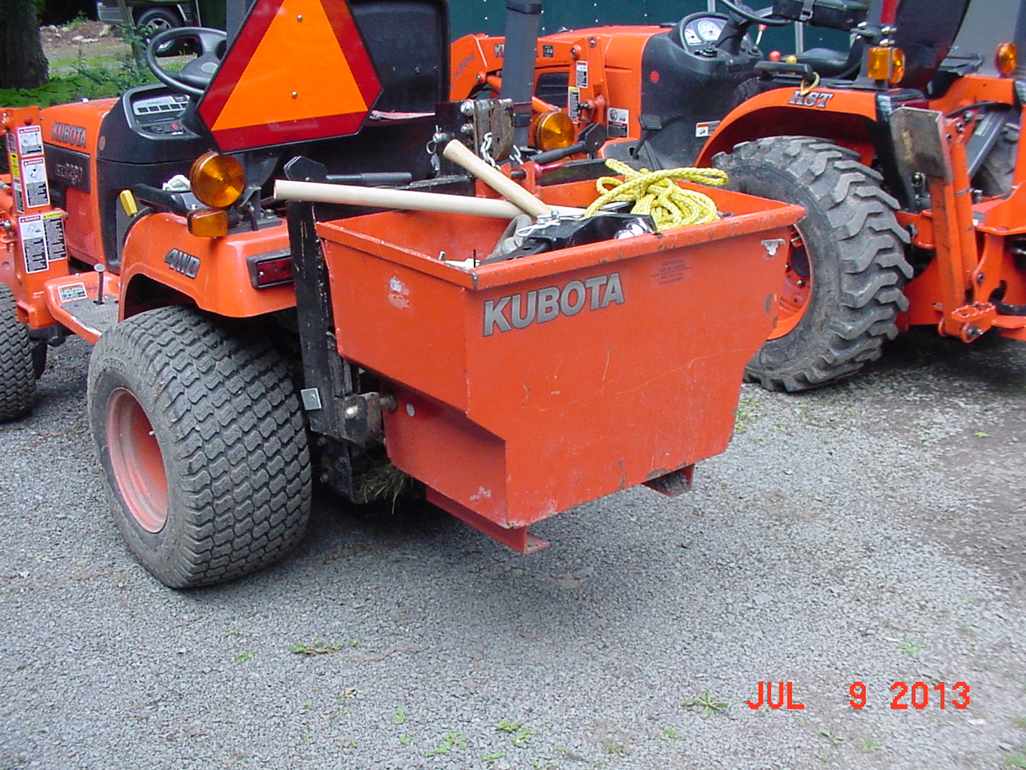

The counterweight that came with my BX was not so compatible with my quick hitch. The only way to get the top link attached was to use a small chain and the bottom links barely hooked on and would not lock. So I blame 4Shorts and his mods for getting me motivated to start gathering all the parts I had accumulated and finally put them together. The receiver tube was long enough to extend through the box and get welded to the front and back. Now it is easily mated to the quick hitch and is ready for work.
Old mount not so compatible: DSC00086.JPG
New lower mount extensions top link solid bar and receiver:

Have you given much thought as to what you're going to fill it with to get to the recommended 300#?
Thomas
   / BX Counterweight Upgrade
I used what was handy, driveway stone. Did not weigh the stone but put in a sufficient amount to keep the rear wheels on the ground with the bucket filled with stone. In the future I want to fill the tires and lessen the amount of ballast I need for loader work.
Well you did good. When I did mine I used class "A" gravel in it and the weight came in only at 250lbs. I was hoping for more but with the ballast box on the BX25D I could pick up a full bucket of gravel and the rear stayed down so I'm happy with that. I did mine different than yours because its a different box. I also wanted as much ground clearance as I could get so that's why the trolley to lay it on after its use.
