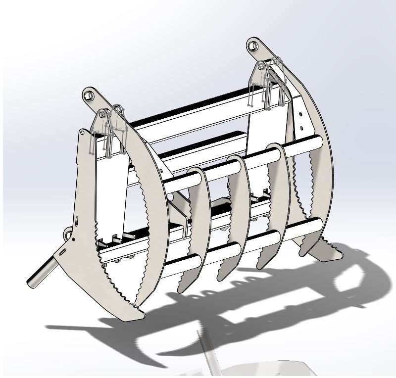

Speaking of grapples, a new subcompact Wicked Grapple is in the making.
The 48" BX model will be under 200 pounds, but it's constructed from AR400 steel and beefed up in the right places!
We'll also offer a 54" with certain B series pin on mounts, JD quick attach, and the universal quick attach.
Here's a sneak peek. Check out those Wicked tines for gripping & ripping!
Travis
