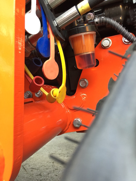

I don't understand why a BX would need 2 filters when my B26 only requires one.
I am wondering the same. The question in my mind is why does the fuel pump on the BX need the filter in front of it? I wonder if the B series fuel pump is different? Maybe the BX fuel pump is more susceptible to clogging?
/ BX Fuel Filter Change Lessons Learned #22
The electric fuel pumps do not work well with crap in the check valves or dirt keeping the slug in the pump from moving. the diaphragm lift pumps are a little more forgiving.

My dealer shop informed me that the filter ahead of the engine injector pump is strictly to protect that vulnerable close tolerance element in case something gets through the first filter and/or the booster pump comes apart. I was able to replace the filter under the cowling w/o removing it, but it was difficult enough that I moved it down under with the first filter. Even the hoses were the right length when reversed. I use steel body filters instead of the OEM plastic ones (more insurance from damage). I also installed a valve ahead of the first filter to eliminate trying to clamp the hose off. If I ever leave the tractor setting out somewhere I can turn off the valve and then defy someone to drive it off as the key is pretty easy to circumvent and they are all the same combination. I have never found debris in the second filter even when clogging of the first one stalls the engine. I am looking for a spin off cartridge type that will fit in the space down under, but it is not a priority. I do not have under body armor yet. Thinking on something easy to remove as I now have the first chewed up fan to replace.

Hi Ron! Yeah, when I replaced the filters, the first was pretty dirty... causing the loss of power. The second was clean. Replaced it anyways. On the ignition keys, I was told by our dealer that they are all the same. I don't know if that means for all BX's or all Kubotas! :eek:

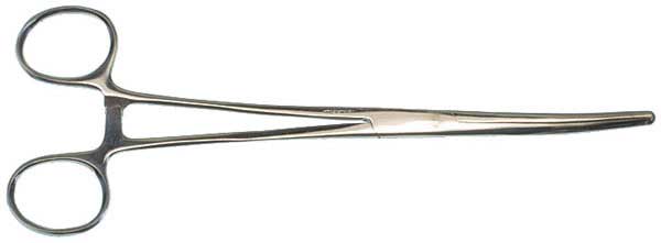

Yes, it is an old thread, but a valuable one. I have to say THANKS! for the info in it. My BX24 was stumbling and wouldn't rev. I found this thread on a search and it saved me a bunch of trouble. I only replaced the primary filter, but that was the culprit. I also only had to go under the tractor one time because I took a box with everything recommended for a filter change in it. The filter bolt was VERY tight. I did use a large hemostat clamp and a small vise grip to pinch the hoses. I tore off a piece of the cardboard box and wrapped it around the hose that the vise grip clamped onto. Oh, the tractor was sitting in the snow, so I found one of those insulated, foil faced windshield sunshade things and used it as a 'creeper' on the snow. Perfect.
