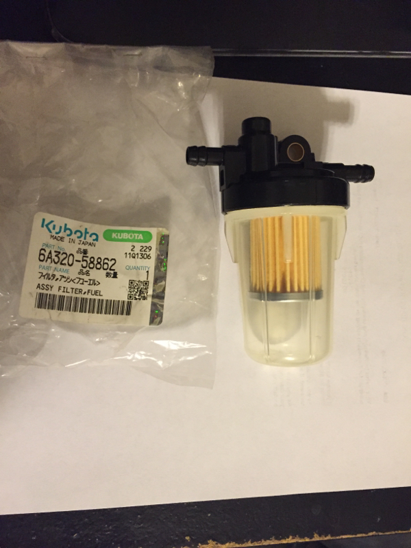

get one of these. They are only $16 from your Kubota dealer an work great. They are from the B series they said. View attachment 418308 with a little fabed up bracket by the pump it works great.
My dealer must be ripping me off. That fuel filter assembly is replacement part for my B26 fuel filter housing and he sells it for $25 plus tax. The filter alone is $15. The clear housing contains an O ring at the top which is $2. The filter has one on it also and doesn't come with the filter. Luckily I had an O ring kit that containers the small one when I changed my filter. Pricing for Kubota parts are a bit ridiculous

Does the bowl contain the water that was filtered out? Or is it just there to make it easier to see when the filter is dirty to change it?
   / BX fuel filters what gives... #17
Yes the water will collect in the bottom of the bowl an you can also see when the filter needs changed.
My plan too. Did you eliminate the first in-line filter under the floor, and swap this out for the second one up near the engine?
   / BX fuel filters what gives... #19
Yep I took out the one behind the fuel pump. I left the one alone at the injector pump. You just have to extend you fuel line to your new mount wherever your putting it an block off the return port that's sticking out on top of that filter setup. They said is wasn't really needed so we just used a screw that fit tight in the port an used sealant on the treads.

This is what Messicks charged me in December.
6A320-58862 Kubota 1 21.20 Fuel Filter Assy
6A320-59930 Kubota 1 14.11 Fuel Filter (element only)
