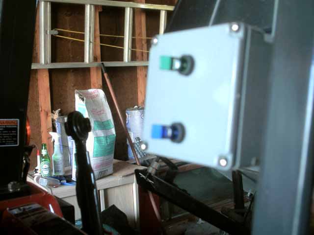

Thanks, that works and I will put the rear facing (2)55 watts on that circuit for the standard rear work light. I have also rigged illuminated toggles on the forward side of the SMV bracket in a weatherproof junction box. I want to run a seperate circuit for the forward facing lights from the 20-amp spare fuse in the stock fuse block. I just need to figure out how to get a keyed, hot wire to the junction box. I was surprised there was not already one there. I hade some steel plates made and I am going to cold weld them to the ROPS and paint them Kubota Grey. I also have the heavy duty alternator on order. It should come from the dealer when the snowblower comes. Has any one ever run a keyed hot wire to the fuse box? /forums/images/graemlins/grin.gif

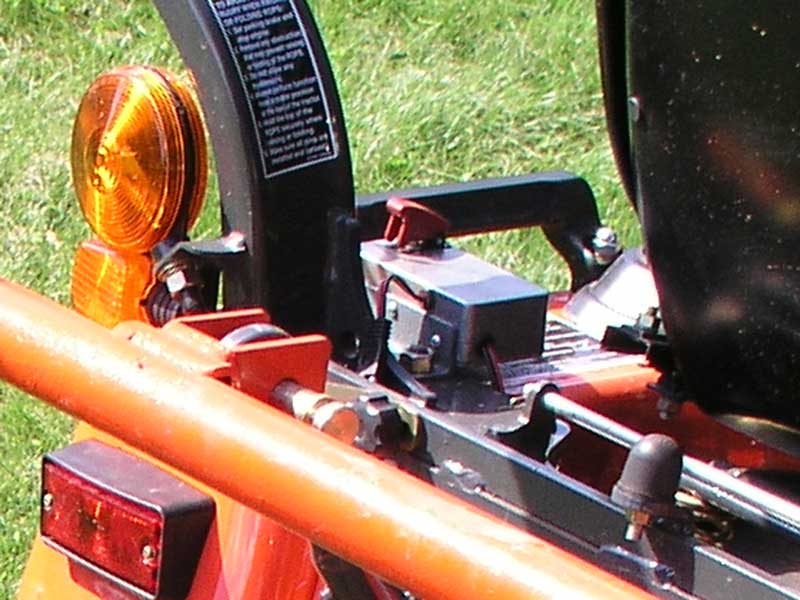

I used the ones under the seat for the sprayer and plan to use them for Work lites also as soon as I find lights I like. I found a picture of the swicth box I installed. I put a polarized pigtail on it so I could use the same switch for the sprayer or lights.
BTW
What is "cold weld"?

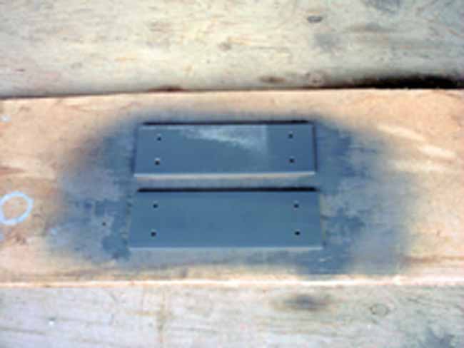

</font><font color="blue" class="small">( BTW What is "cold weld"? )</font>
Bernie
Cold weld is like an epoxy mix of two sperate components, I guess a glue and a hardner but works very well on metal and dries just as hard. It is great for adding a muffler or exhaust to a small engine when you do not have the proper fitting. I don't know how well it will adhere without the significant amount of heart that runs through an exhaust as that does help it cure. Time will tell (or the first tree limb) if I have to make clamps or find 3" u-bolts with threads starting at 1.5" up the ends. On the plus it dries to a Kubota gray! /forums/images/graemlins/cool.gif
I will post pictures when I get back and finish it.

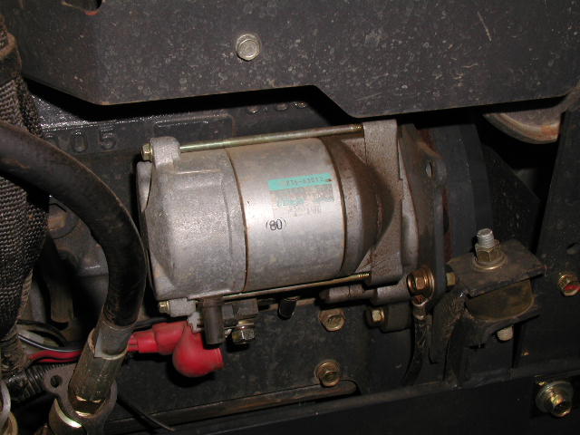

Steve:
I finally looked at how I had obtained the power for the lights that I mounted on the ROPS.
It turned out that I ran a power wire directly from the main source of the other switched power, which I believe would be the block mounted to the starter motor.
See photo

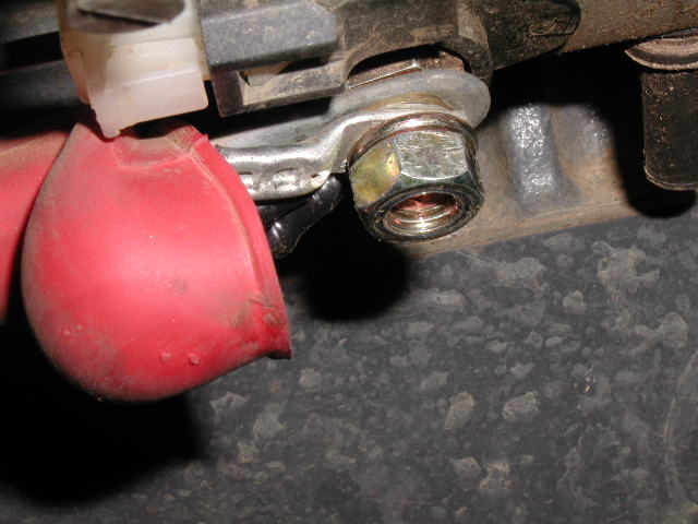

   / BX Fuse Box Question- Spares #9
Close up
