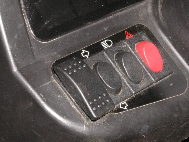

I then mounted a SPDT (center off) switch to the dash. This switch will only allow one set of lights to operate at any one time.

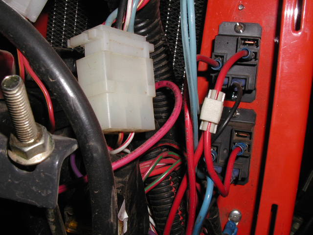

I took the switch leads to two 12 volt, 20 amp relays that I mounted to the firewall next to the battery.

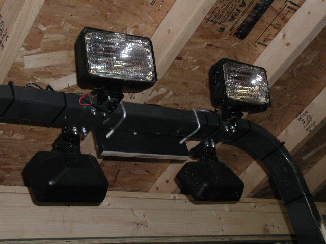

And then to the four lights mounted on the ROPS.

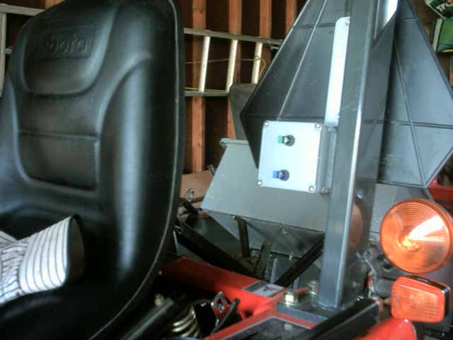

Here's my switch in a weather proof box. I saw someone else do this, so I do not take credit. I was reluctant to cut in the dash, so...
   / BX Fuse Box Question- Spares
#20
Here's a better shot of the switches. They are illumunated toggles. I will put a little electric grease in the base of them to keep water out as they are not (and should be) marine grade.
I will post the rest when I get back to it.
