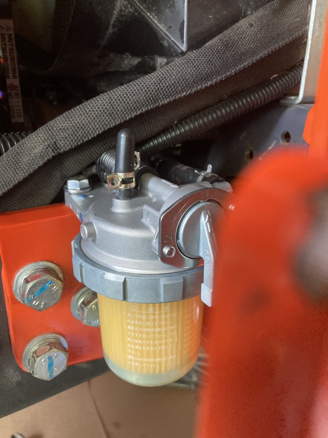

i moved the filter and fuel pump up under my hood. Removed the oem filter before injector pump and added a filter with sight glass bowl and shut off . Ever thing all in one small spot.

Yes, the filter physical location shouldn't matter, as long as the hose arrangement keeps the filter in line upstream from the fuel pump. I bought a kit with a spin on filter, but there's no reason you couldn't just relocate the original one yo make changing it easier.

I made my own setup after seeing someone charge $200+ for it, mounted it on outside of left loader saddle.I bought all materials for about $150(bought a 6’ piece of 2-1/2” aluminum angle ($30)and 25’ of fuel line off eBay(around $20)The oem Kubota filter housing was $80, the 5/16” hose splice about $5 from Napa, some black plastic wire protector (1/2” I think) from Harbor Freight for around $5 to protect line from rub spots, some spring hose clamps for around $5, and some zip ties. I made one for my BX1870, then another one for the BX2380( had the angle and fuel line already from first one). Custom made the mount bracket for fitment from aluminum angle. Where filter is underneath is where you put the hose splice, then run the line to the outside mount, then I ran a line back to the inline electric pump. Only thing I don't like about the Kubota housing over the Racor is that it doesn't have a drain on bottom of bowl...
