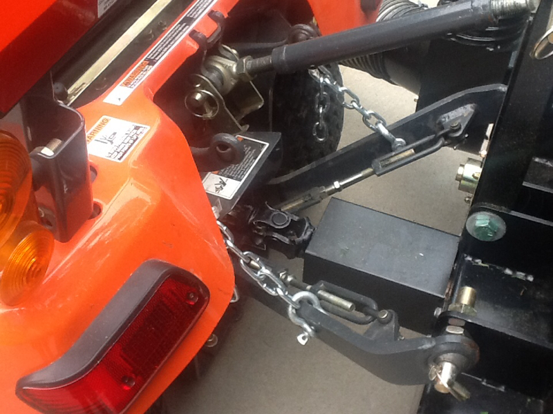

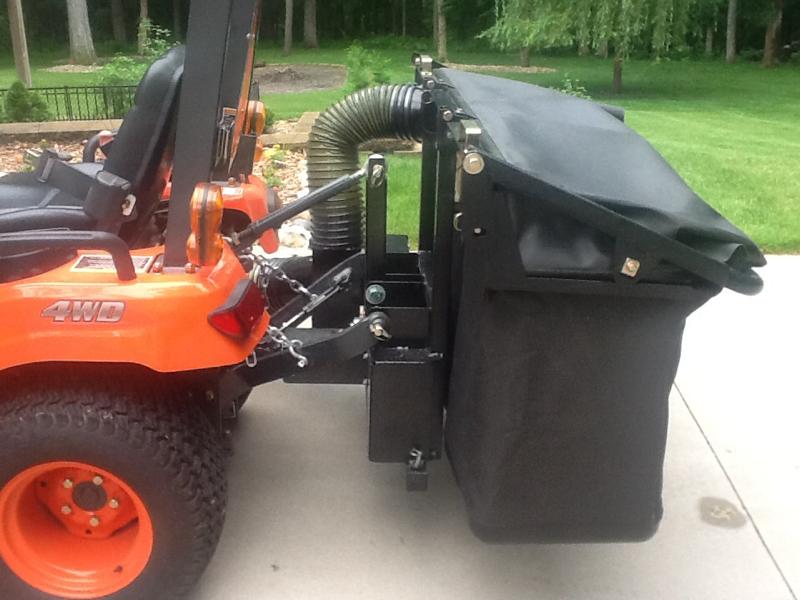

I bought a third party bagger and mounted it to the three point hitch hanging the arms with chains from the fixed mounts. It works very well.
Ah - I see! Is that a PTO driven auxiliary fan? Cool if it is. Who's the 'third party'?
