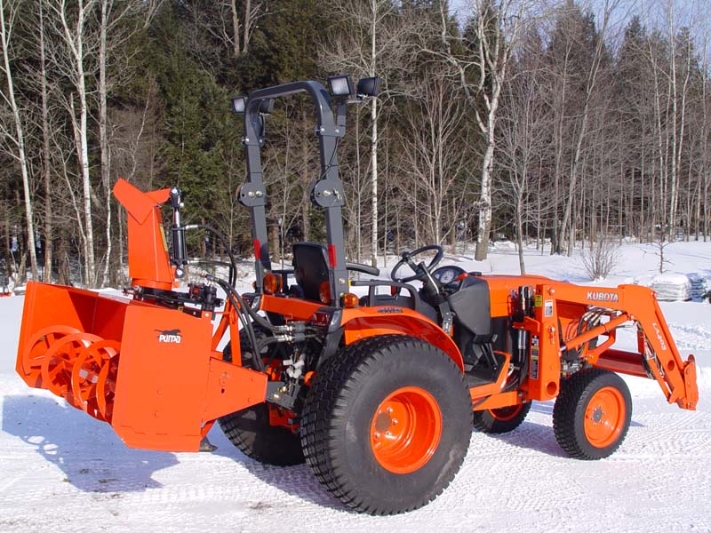

I have a rear blower and a FEL. I spent the last two days moving snow and I think I have the best setup that I can wish for in my situation. I have a snowblower mounted on my tractor since my first Kubota (before that I had a walk behind snow thrower 12HP 33"). By experience, I think the blower is far more efficient for a big snowfall than a FEL. When the blower is completely raised it can bit a drift nearly 4' high. When it's on the ground, the bottom blade is half an inch from the ground (most of my neighbours (and me) don't have a paved driveway). The final result is a pretty hard snow surface perfectly even (even if the neighbour rolled over his snow bank with his F350 many times). The rotation and the angle are controlled by hydraulic cylinders so I can put the snow where I want.
What I like the most of a snowblower is the fact that it compacts the snow a great deal so the snow banks take less space and let's not forget that it's very pleasant to operate. One other thing is the fact that a snowblower requires nearly no traction to operate because the snow is not pushed on the side it's completely taken away. The only friction is the weight of the snowblower on the skid shoes.

I like the idea of the FEL and rear blower as well - question - Kubota seems to say a 4' blower for the front off the mid-PTO... since the rear PTO goes slower and has more torque - think a BX24 could run a 5' rear mount?
   / BX snow thrower vs loader? #39
IMHO there's no torque difference between the rear and the mid PTO at the end (I mean after the gearbox mounted on the snowblower). The gearbox for a front snowblower reduce the speed. The point is, they both turn at the same speed (if not, a front one would throw a light snow 200' away but would bug down with heavy wet snow).
About the width, I have a 64" mounted on my B3030. It was mounted on my BX23 before I swapped tractors. It was ok mainly because the BX23 had an hydrostatic transmission (meaning: you go slower, that's all). If you plan to break the fastest snow removal world record I'd recommend something smaller though. But it was very fonctionnal and if I had to do it again I would do it without any hesitation. The situation is the same with my B3030, when there's a 18" snowfall I don't back up as fast as if there was only 6" (dry or wet snow is the same logic).
Two pics: B3030 and BX23... same snowblower.
