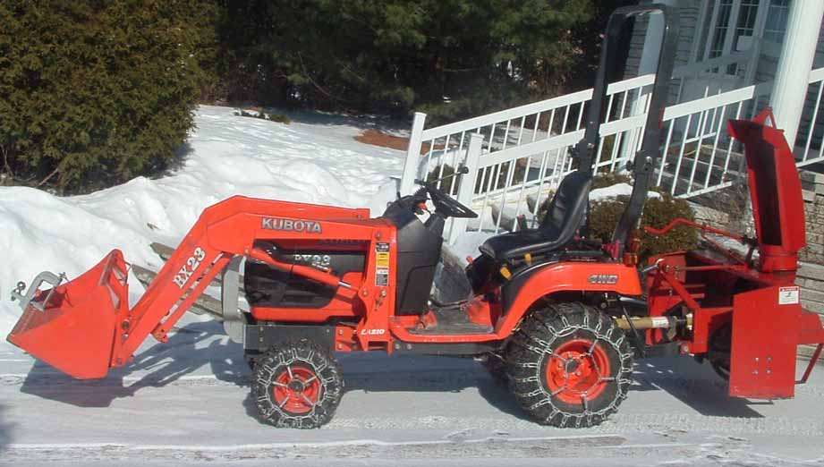

I love to have both a blower AND a loader option. I use either ONE or BOTH depending on the snowfall.
The reversed snowblower is very easy and pleasant to operate compared to the other 3pt design. This inversed design also has the advantage of doubling as a type of boxblade to scrape a light snow fall away very quickly.

I don't see that design on their website pictures? Did you modify it? Cost?
I like that idea so much better then backing and blowing... Do you have any problems with packing the snow with your tires before it is blown? Does it clean just as good?
Phil

That's cool - same questions as Musclford about the packing and tires...
Also - I'm assuming this is an obvious - but there is some sort of physical limitation on the rotation of the chute - right? Cause I have this whole mental image of a Bugs Bunny sorta moment of me blowing myself right off the tractor awash in snow, gravel and ice!
Also - how does the chute rotate - is it that big handle thing... and isn't that difficult to operate behind you?
And - how wide is it?

You can see more photos of my rig (see post #9) at this link:
http://www.tractorbynet.com/forums/...snow-w-new.html?highlight=agro-trend+inverted
This is not a modified unit, and I do not understand why this model would not be displayed on the Agro-Trend site. This inverted design works very well. There is no problem at all with packing the snow with the tires. I especially like the added bonus of being able to drag the snow out of difficult spaces where blowing is not feasible.

This particular Agrotrend reversed snowblower is model # C48PBH. Although this is the smallest model at 48" wide, larger models are also available.
The chute rotation (and safety) limitations resemble what you would find on other conventional 3 point blowers. The photo shows the chute facing forwards at maximum forward rotation. This is very handy for bringing snow forward in difficult areas where there is no side or backward direction to throw. As you can see, this model still has a munual chute, but I plan to convert it to hydraulics by next winter.
