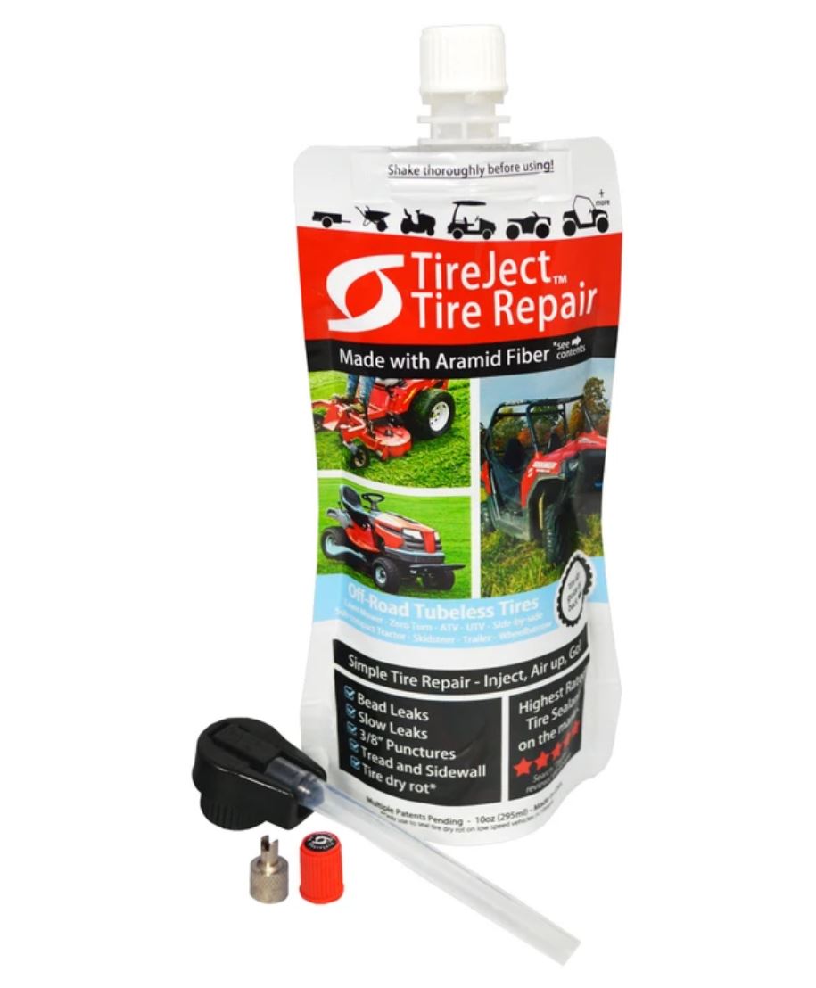

Hi all,
it's been almost a year since I started this thread. Just wanted to let you all know what was going on.
I bought some of this stuff called TireJect.
I took the wheels off, pulled the valves and injected this stuff. I rolled the tire, and flipped it around to coat the inside.
Put the valves back in and aired it up.
Have not had one problem since. Oh by the way it was leaking around the rim. FIXED!

Yup, that stuff works for most minor leaks. I have R4 tires on my B2910, and had a couple of leaks in the front tires, due to running over thorns. I bought some "Slime"...which is probably the same stuff you used, and treated the front tires 3 or 4 years ago, and they haven't lost any air yet. The rears have held up well, but they have heavier and deeper tread.
