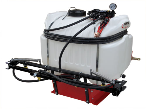

Anyone use one of these 12 volt sprayers on a BX? The 12 volt pump requires 8 amps, just wondering if the tractor has that spare capacity available.
FIMCO 4 Gallon 3 Point Sprayers

I use exactly that sprayer on a 2014 BX2670. No issues whatsoever. Must have ran 6-8 tanks through it so far.
Hope that helps.

Thanks Glenn awesome. Do you use the sprayer clamps right on the tractor battery or did you wire up a connector through the tractor fuse panel? Ideally I'd like this on a fuse protected circuit. Also what do you use the sprayer for? I'm done with spending $300 on Scotts weed and feed which at best makes my weeds feel sickly. I'm planning to go to a sprayed herbicide to kill off all the broadleaf weeds in my lawn.

I use an ATV spot sprayer with my BX so intermittent running. It takes a toll on the charge and I put a trickle charger on it when I'm done. You could probably use a marine battery as a stand alone and get along that way. I don't remember what the BX alternator is rated at, but I don't think it could keep up. My BX is a first generation so yours may have a higher rating than mine.

I have 5-6 acres of lawn and I use it for a spring/fall broadleaf weed kill. It seems if i go at 1500RPM and WOT in low range with 30LBS nozzle pressure the grass is just so wet with chemical. Works great. I have been using a chemical for farm sprayers that i can't remember the name of (old age). The stuff is about $80 Cdn for 10L. I expect any broadleaf killer will do this with the proper ratio.
I wired a 12v Lighter-type plug on the end of the factory wiring and use power from the 12v plug under the seat. The factory plug is fused. I have never had a battery drain issue and when i do this it is typically the whole day (8Hrs).

The BX alternator is now 40 amps, I think on earlier BX it was much smaller maybe 15 amps.
