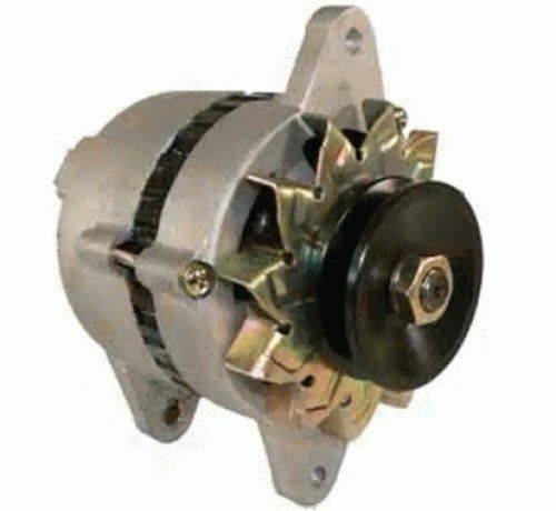

My 1999 BX2200 has a dynamo, low amps & my 2006 BX24 has the 40 amp alternator. The best way is to open the hood & see if you have a unit that looks like the ones on small cars, you have the alternator. dynamo.jpgalternator.jpg
   / BX Tractors and 12 volt 3 Point Sprayer #13
My 1999 BX2200 has a dynamo, low amps & my 2006 BX24 has the 40 amp alternator. The best way is to open the hood & see if you have a unit that looks like the ones on small cars, you have the alternator.<img src="http://www.tractorbynet.com/forums/attachment.php?attachmentid=548194"/><img src="http://www.tractorbynet.com/forums/attachment.php?attachmentid=548195"/>
Kk thanks! Will have a look. Mine is a 2009 Kubota BX 25, so I probably have the 40 amp alternator.

There were still some dynamo's in 2008, kind of weird Kubota was using the dynamo on BX23's the alternator was an optional upgrade, but BX 24's came standard with the alternator.
