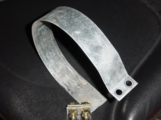

Just snapped mine today. Started up the tractor to plow some snow...came out 10 minutes later to the tractor rattling and banging under the hood. At first I thought the engine had a major problem. Then I saw it was the bracket..whew!
A couple of zip-ties and I was back in business...
   / BX Warranty/Air Filter Bracket #15
Called the dealer; they don't stock them; will have to wait a few days. No problem to cover under warranty.
Here's the culprit....
