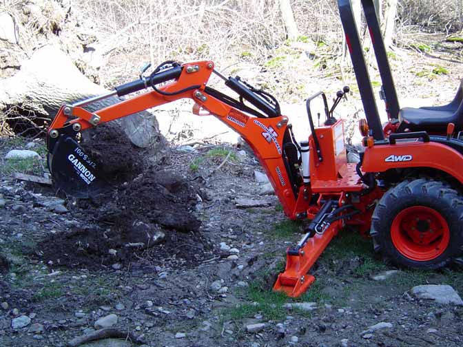

Pic #11:
   / BX1500 and Woods BH6000
#12
Pic #12:

Thanks for posting these, bmw! I'll be curious to hear how it continues to perform for you. Keep us posted, wouldja?
   / BX1500 and Woods BH6000 #14
Nice job. How is the headroom with the ROPS? I note that Kubota puts on a taller ROPS with the backhoe models like BX-22, 23
#15
I am 5'11" and have no problem with head room and the ROPS. Plenty of leg room as well. Excellent visibility. The Woods engineers did a great job designing this BH and fitting it to a BX.

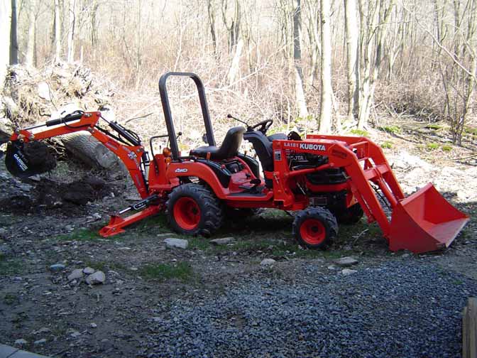

   / BX1500 and Woods BH6000 #16
BMW,
Great Pics! THanks for posting. I am sure this will give hope to other BX1500 owners who thought that the possibility of a backhoe on their machines was a best a dream that would never come true! /forums/images/graemlins/cool.gif
For extra weight on the front, you may want to consider having your front tires foam filled. It adds a fair amount of weight. I had the fronts on my BX2200 foam filled, and I carried one in each hand when I dropped them off. Coming back out, it was one at a time... /forums/images/graemlins/blush.gif
Great looking tractor, by the way!

Looks good! It does look a little bigger on that 1500 than it does on the BX2230, Case DX24E, NH TZ24DA, & JD 2210. I got ahold of an installation manual, and it looks like the Woods engineers spent a lot of time really working things out, and setting everything up to fit each of the different machines very nicely. /forums/images/graemlins/cool.gif
   / BX1500 and Woods BH6000 #18
Are you sure that's not the new L39? Actually that looks very nice, wish I could justify (and afford) to add a backhoe, but I would probably get tired of just digging holes to dig holes as I don't have any projects to justify /forums/images/graemlins/frown.gif
I see you don't take no for an answer. I'm sure you were told it wouldn't work at least a few times. I'm sure other BX1500 owners will be glad to see someone took the initiative to make it work.
Did you have any special changes to make it work? Anything you had to fab specifically?
Thanks for taking the time and posting pics also.

Surfran,
It is stock right from Woods. No modification was done on the BX1500. However, as I mentioned earlier, it is a little back heavy and I have loaded the front tires to help. I may take Henro's advice and foam fill them or mod out suitcase weights.
