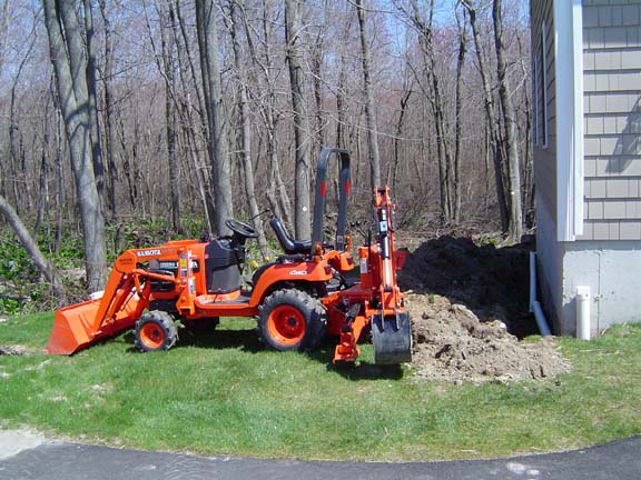

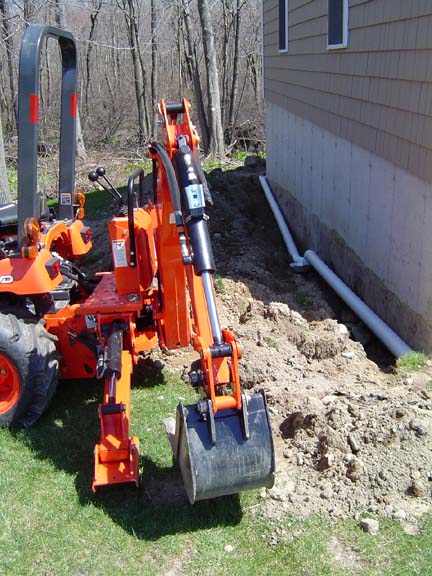

I completed another task with the BX1500 and the Woods BH6000. I installed some drainage pipes for the down spouts on my house. The BH and tractor performed great. Now that I have about 10 hours on the BH, I can give a real good assessment. The performance of the BH is incredible. You can see from the pics (see follow on pics) of the size of the rocks I dug out. Digging depth is good as well (considering the size of the BH), as you can see the deepest part of the trench in the center. The BH is extremely easy to use and is very smooth. It has exceeded my expectations of a BH of this size. Now, onto transport performance. The tractor is definite light on the front wheels. In fact, if you are trying to make a sharp turn quickly, the tractor has a hard time gaining traction in the front. Even with fluid in the front tires, I think I need to add a good 100# to the front. The Kubota suitcase weight system for the BX series is not compatible with the LA181 FEL (there apparently is not enough clearance between the FEL boom and front bumper), so I think I am going to design my own. In addition to that, I think I am going to take Henro's advice and foam fill the fronts. I wont be using the AG's on my lawn for the summer, as I have a set of turfs, so I don't have to worry about making ruts in the yard. As long as I go slow, turning and traction aren't a problem, but I think it can be improved. Other than that, this is a great set up for me.
